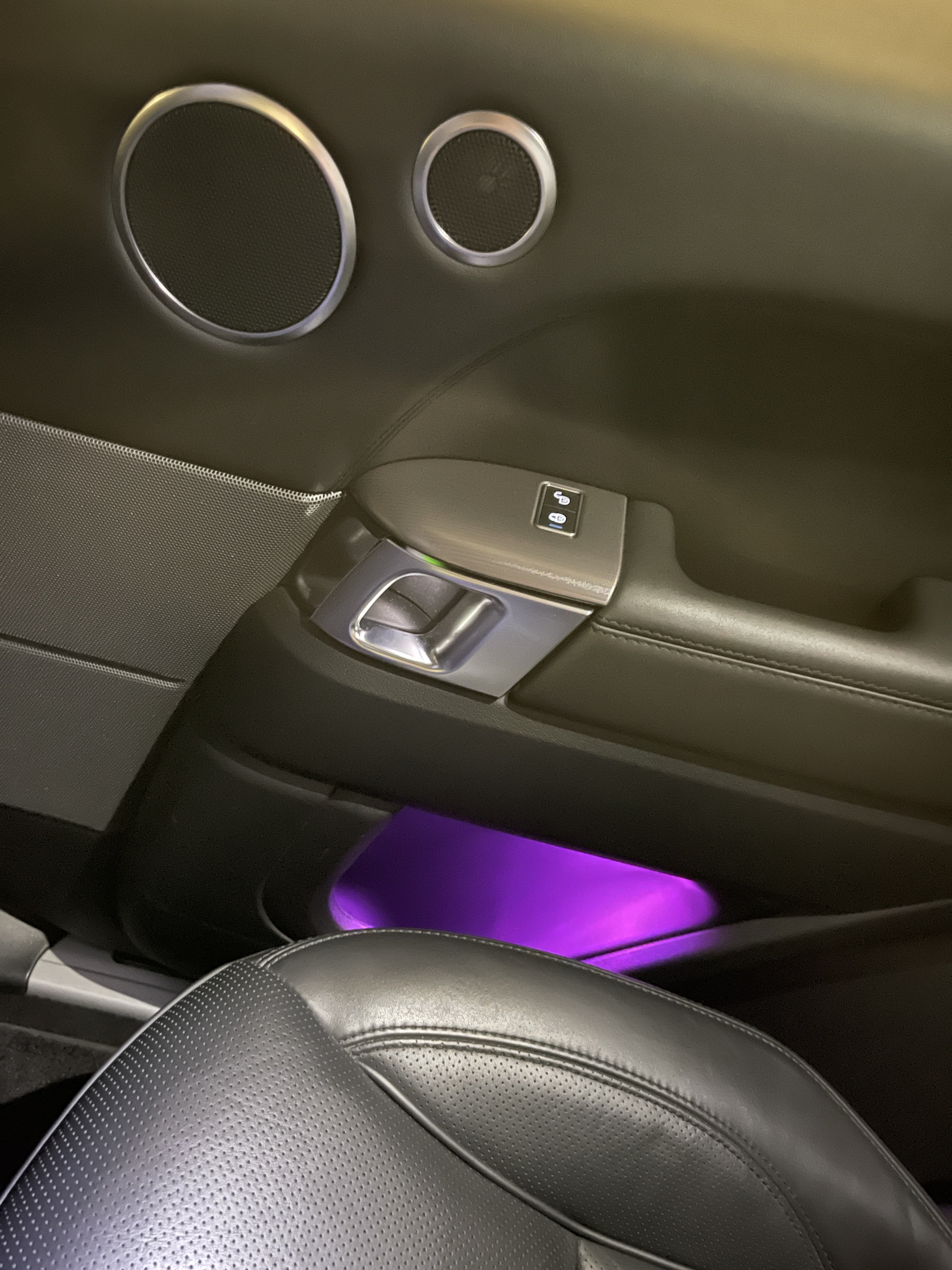

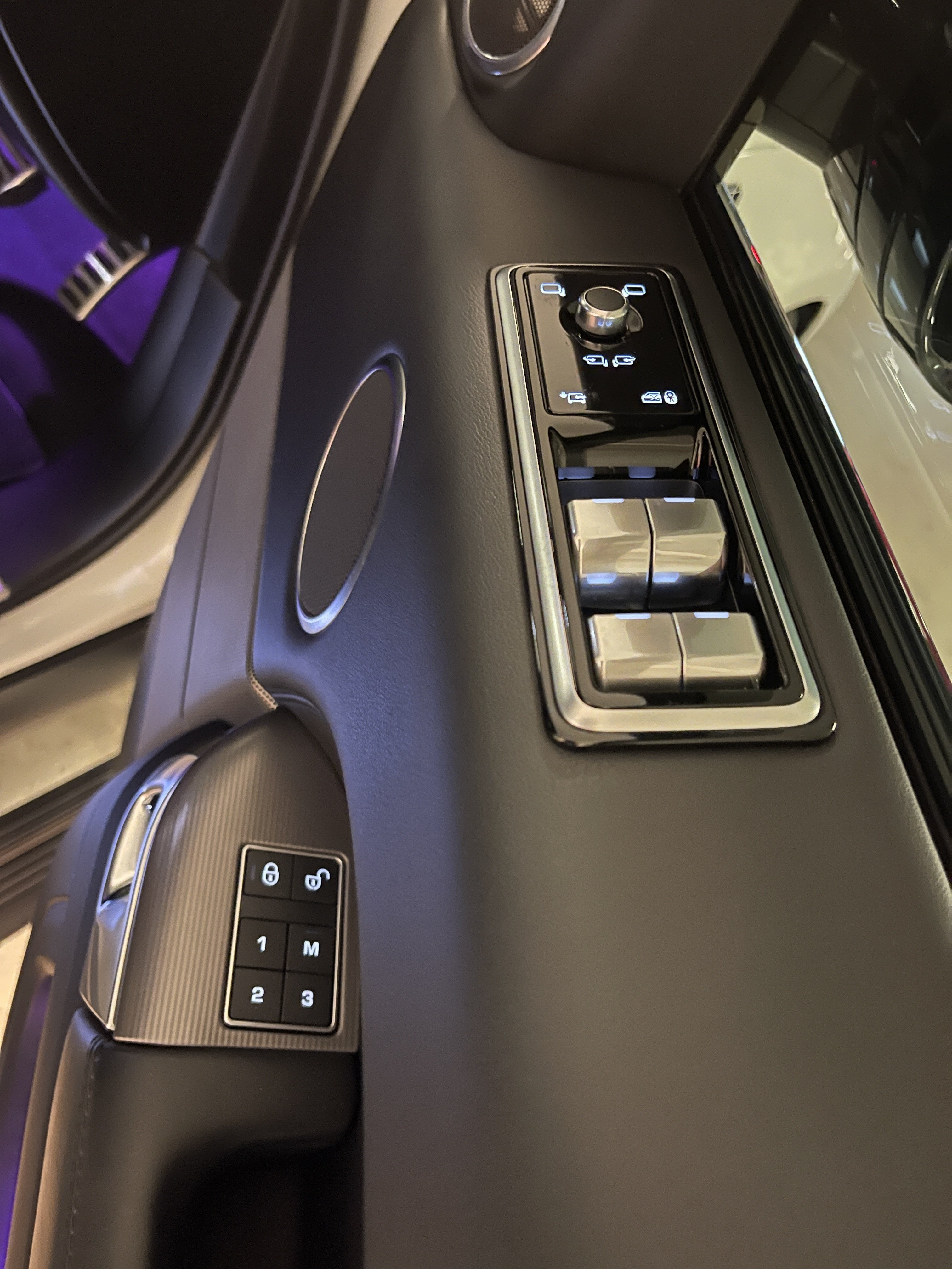

Hi all, did an exterior and interior facelift for my 2016 L494 but many posted exterior before so I go with interior. Basically I change the factory screen to android, aircon panel to the lcd version with terrain mode, change out to 2018 steering with the new controller as well as all the window switches. Lastly as my car has the miserable factory ambient light, I add on other ambient lights to the car and control it via the screen. Oh ya. i also change the digital instrument display.
Here goes.
View attachment 302264 View attachment 302266
