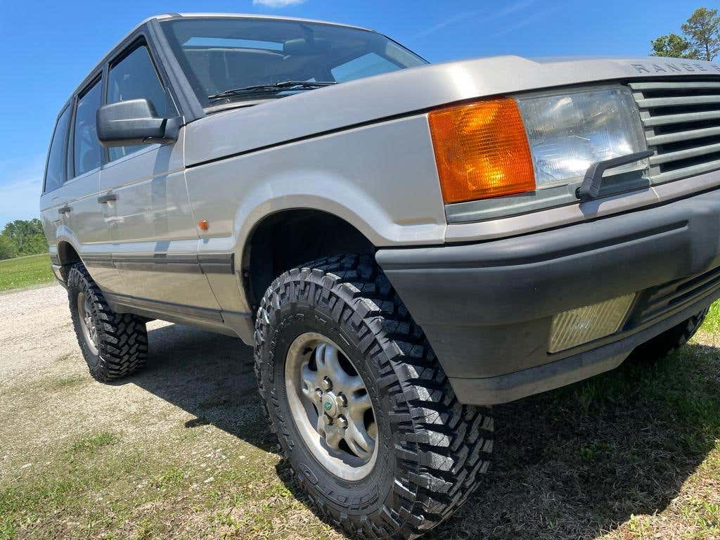

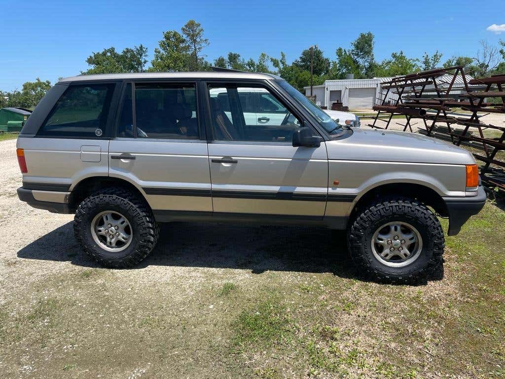

Hello all.
I finally got tires installed on my p38 a couple weeks ago. And it drove great until this afternoon.
I noticed it stalling around 30mph and if I give it gas, it revs to 3000ish rpm and just stays there but doesn’t accelerate. If I let off it feels like it grabs again. I had just finished changing the diff and transfer case fluid. Which makes me suspect the transfer case but the fluid as darker red, and I didn’t notice any metallic specks or anything. And had no signs of issues before.
The rear diff oil was very dark. I was planning on changing all the fluids again in a few weeks.
I also have everything to service the transmission and was planning to do that soon. Would fresh fluid and filter help?
I am also noticing it will die when the gas tank around 1/4 full and idling for a few minutes. Starts right back up though.
