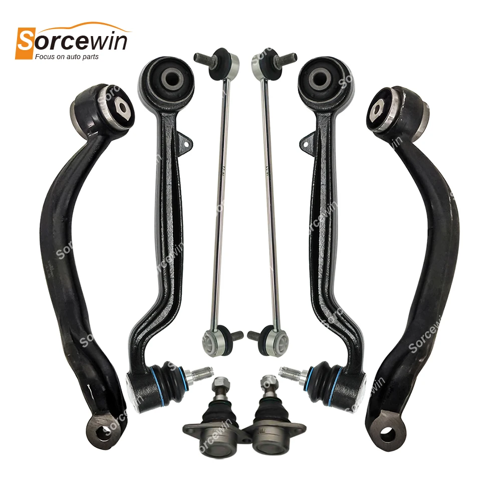

I took my Rover in for an alignment and the guys advised me that there was excessive wear on most of the front end. They want to replace upper and lower control arms on both sides as well as tie rods. I found a chinese company with a complete set for $300 cdn including shipping. Has anyone any experience with these?

This is normal these are heavy cars. There aren’t actually any upper control arms. Any wear is usually the lower ones and you can hear it in your normal day to day driving. I think most after market parts are Chinese anyway and are just packaged or re packaged as German or European manufactured or whatever. You will get a couple of years out of the cheaper bits if they are properly fitted.
There's a couple levels of quality of all these parts with lots of debate about which ones are best. I try to buy the best ones so I don't have to do it again as soon and have good steering in the process. Steering parts are not the place I would buy the cheapest version. But do whatever you feel comfortable with.

Wow - lots of great advice. Thanks everyone. I see that the Lemfoerder options add up to at least $800 which is USD and there would be shipping and CDN tax on top. The China option is about a quarter of that which makes the possible replacement after a couple of years more palatable. I'm going to sleep on it but suspect I will take the easy way out. Thanks again!
