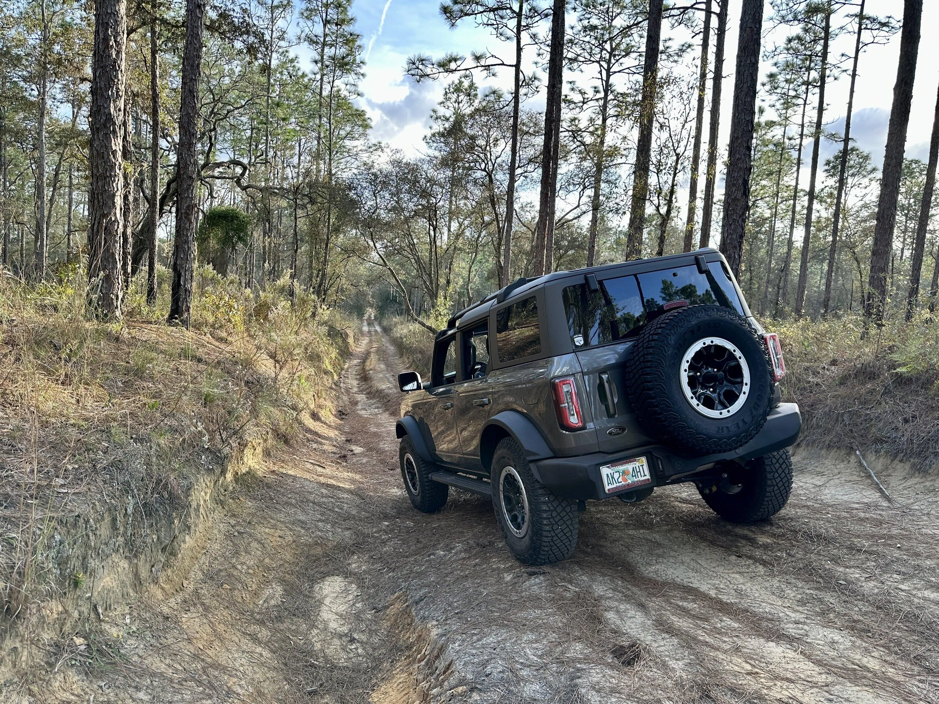

Since everyone loves a picture, here is one of the Bronco in the same area I will be heading to...
If that terrain is typical, your stock RRC should be able to handle that without issues, provided you've baselined the major systems. Just make sure your fluids are good, topped-off and no leaks. Make sure all the joints have fresh grease and zerk fittings are closed. Make sure the lo-speed works. If the low range hasn't been used in a while, make sure the shifter linkage hasn't seized.
Maybe air down the tires on the trail and pack a portable air compressor to air up the tires for the trip home.

Yeah it is usually pretty tame. The only thing that can really get you are the mud holes (which I tend to avoid) and the sugar sand.
I don't even air down in the Bronco usually. But it does have front and rear lockers if I really get myself in a jam. Which I never have lol.
