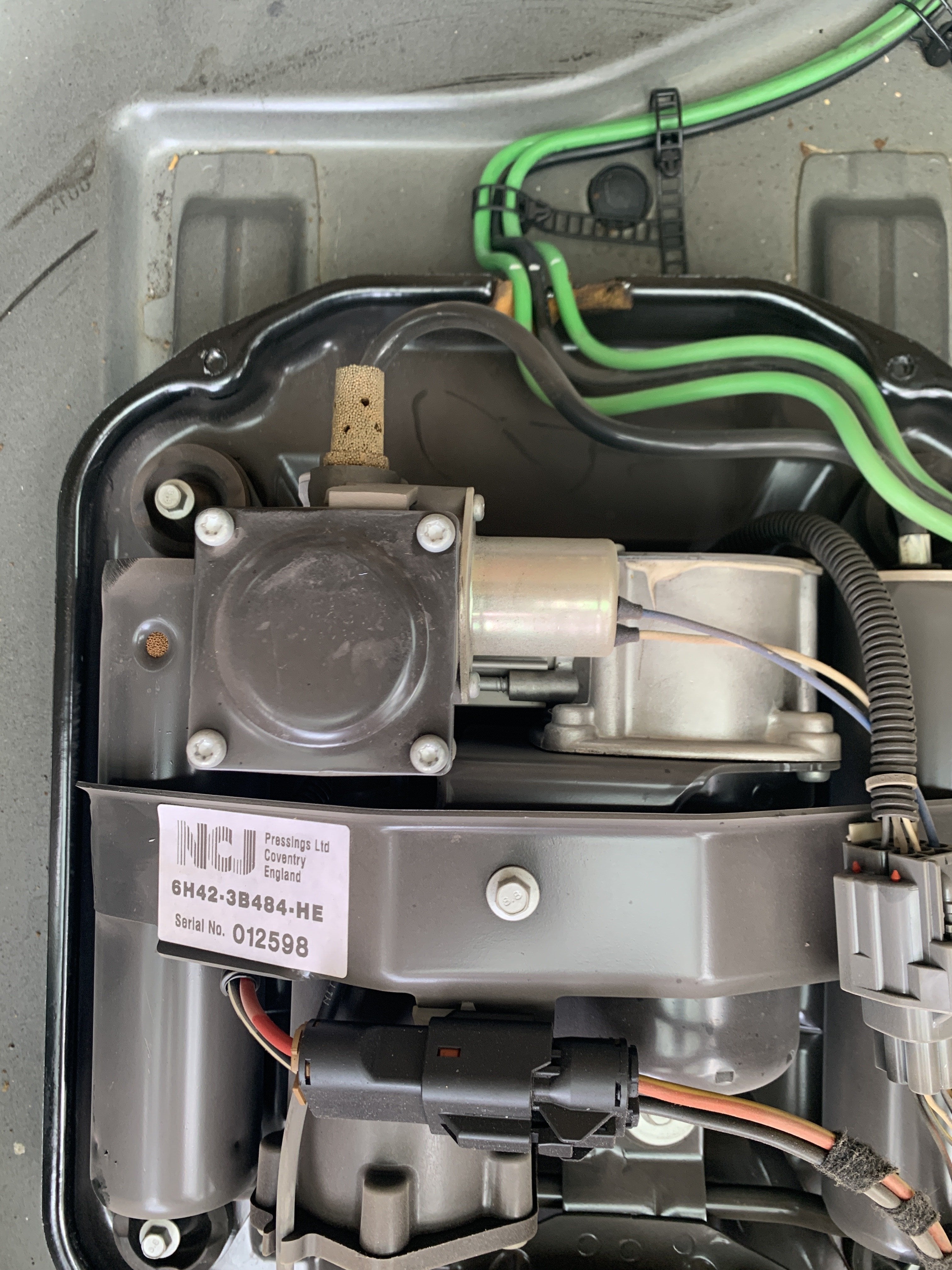

Still wondering if there is a way to put a multimeter to the air compressor to check if its still good (as in not dead / operable)?
Im thinking I have a bad / dead compressor. Any way to confirm this? Any recommendations for replacement?

Today, I checked the relay (passenger side cargo area panel). It read 78 ohms. From my brief readings, thats a good relay. Couldn't find a 9V battery ,for the life me, to further test the relay, but Im satisfied with the multimeter reading. I removed the spare and turtle shell, noticed there's a very obvious layer of dust over the entire compressor. The cover housing was well sealed and the insulation appears intact and not brittle. What gives with the dusty film? Could it be a side effect of what caused the compressor to give out?
Still looking for plug and play replacement compressor suggestions from the community. Im thinking this is a Hitachi, do I have to replace it with another Hitachi or is there a suitable aftermarket one I can use that wont require any software coding / matching?

Rather than chase down gremlins and troubleshoot my compressor, Im just gonna replace it. I found this one:
Hitachi part # CMP0002. Matches up with Land Rover part # LR025111.
Anyone have any personal experience with this one. Seems to me that it would be plug and play, no programming required.

#19 · (Edited)
Today, I connected the compressor directly to a 12V battery and it runs. So back to my previous post and question, if the system shut down the compressor, how do you get it back up and functioning? The way it looks to me this compressor is okay. NorCal RR noted that if the system shutdown my compressor, it would have been due to a major leak. Because only the front of the vehicle dropped and the rear maintained its height, Im guessing this major leak would have occurred at the front. Im guessing a failed valve block would have caused both air struts in the front to drop simultaneously. Again, Im guessing? What else could have happened that would have caused the both front air bags to lose air simultaneously and within just minutes and cause the suspension compressor to be shut down??

Suggested a wiring diagram to see if your compressor was getting voltage. But I guess you have shown that it wasn't (since it runs in your test). It does appear that your system is faulted and not instructing the compressor to turn on. I don't know the iCarsoft system and if it can reset EAS faults as I use GAP IID. I think others are using it here so I would look for info on how to read and reset EAS codes with your tool.

Thank you. Im going to reinstall the compressor and connect the iCarsoft again and check for anything EAS related or any new codes. Thanks for the input. If this gets any more troublesome, I think coil over conversion is still a possibility. In my brief searches, can't find any kits for 2010-2012s that have VDS, though. Oh well, I wait till I get to that point.
