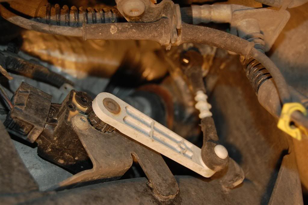

I decided to take off the front right stock rod first.
Pics of stock rod (it's focused on the sensor arm though):
I chose to take off the end that was attached to the sensor arm first - my reasoning was that since the other end is stationary, it would help to keep the arm stable and make for less chance of breaking the sensor arm.
I also decided to use plastic golf divot removal tools, since I figured they would break first instead of the stock rod or sensor arm. I'd rather have that happen then break a part. Spray a bunch of silicone lube around the area and place the divot tool underneath, then you should be able to pull it off with your hand and a little prying action. The top or stationary mount you can get off without the divot tool (on both front and back); just remember to spray liberally with the silicone.
