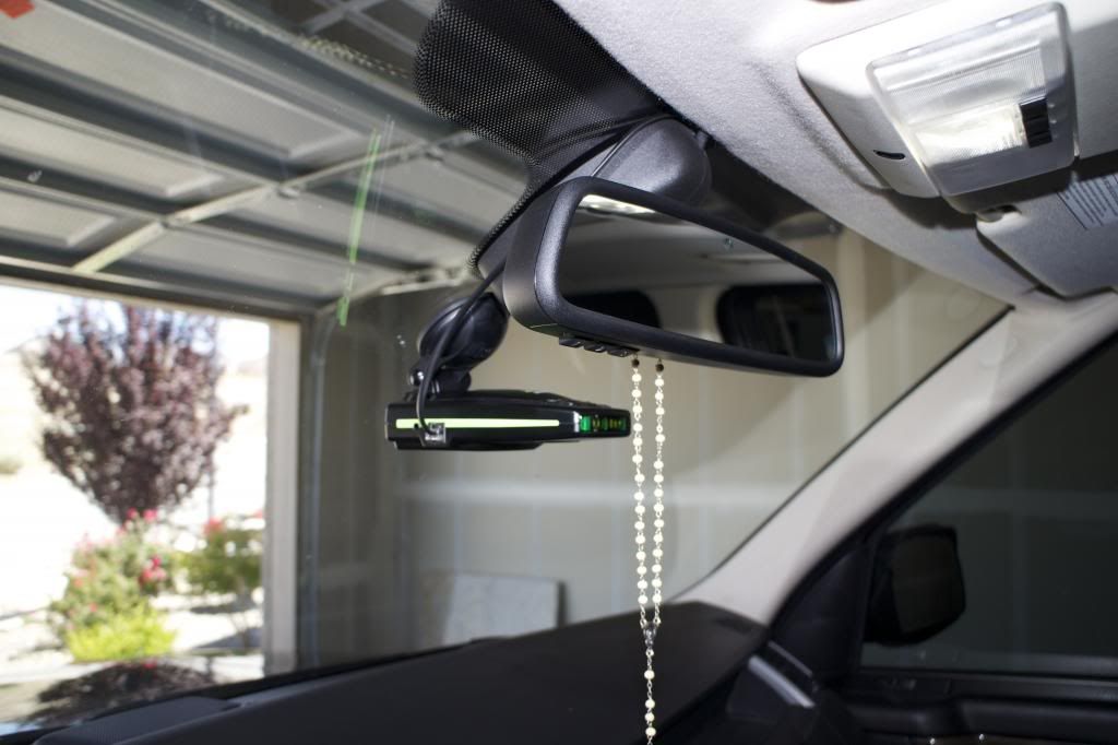

I chose installation of the radar detector just to the left of the rear view mirror. The phone jack and cord easily slide between headliner and windshield, and the "tinted" part behind the rear view mirror makes the wire almost invisible:
And here is the finished installation from the driver's perspective. After wiring everything up, test to make sure you get power to the detector. Don't forget you need to turn on the ignition AND radar detector first! If you get juice flowing, you are done. Carefully align the two plastic studs in the rear of the overhead console with the cutouts in the headliner, and push the front of the overhead panel up against the roof until it snaps back in place. With this type of installation, the detector will automatically turn on when you open the doors with the remote or start the car, and will turn off about 3-4 minutes after you remove the key from the ignition, or right away if you arm the alarm.

I notice the detector is mounted to the left of the dark shaded area directly behind the rear view mirror. Is this done for a reason?
Does the detector not work if it is mounted directly behind the rear view mirror in the dark "tinted" area?
It seems like in the sample photos,the radar would be in the way of the sun visor?
#28 ·
Couple of reasons: The shaded / tinted area above the rear view mirror is a bit textured and not smooth like glass, so getting the suction cups of the detector mount to stick would be more challenging. You'd have to smoothen that textured surface with some layers of packaging tape or something similar to get the suction cups to stick securely. Also, the V1 specifically (this may not apply to other detectors) needs the rear firing radar/laser sensor to have a view of the rear of the car (through the rear window) as unobstructed as possible to spot bogeys approaching from behind with plenty of advance notice. With the detector mounted so high above the mirror, the view of that sensor would be partially obstructed by headliner and overhead console, decreasing its coverage and effectiveness.
The detector doesn't get in the way of the sun visor when mounted to the left of the tinted area, thanks to the slanted windshield of the Sport it sits quite a bit forward of the visor.
