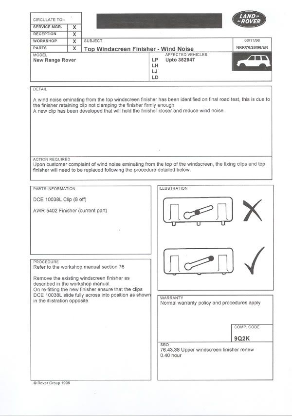

That's a P38 classical : upper rubber strip.
I tried to glue mine but doesn't work. I need to replace it
Just as a Point of Interest.
Is that the rubber seal between the front windscreen and the body?
Yes it is.
If you're not sure try the tape test. Tape it all along and run, you'll know
BTW, do you think i can only replace the clips?
Might be worth a try as the clips are only 90p each and the Trim is £42.00 but it may have the clips included wouldn't know for sure.
