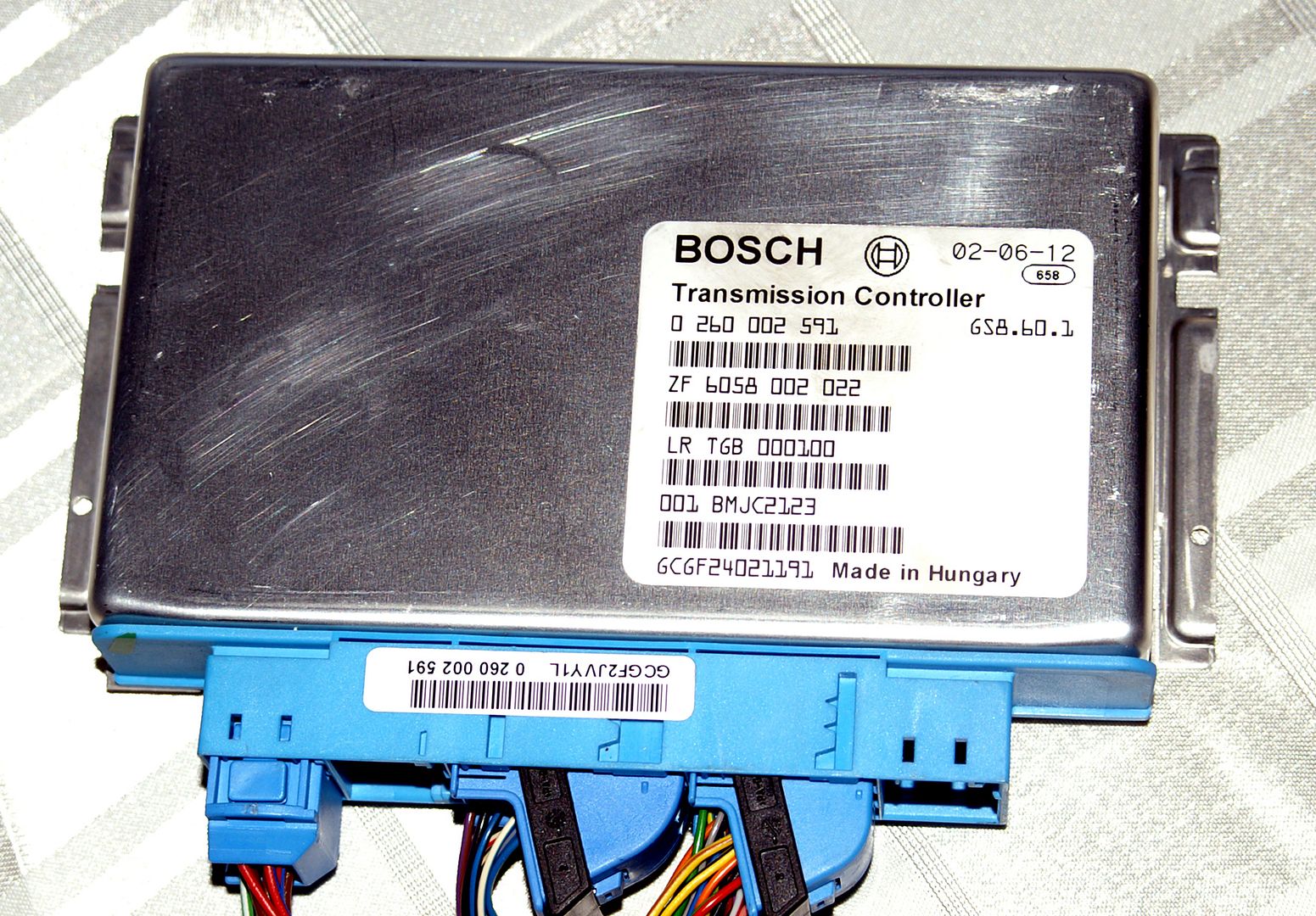

The transfer box ECU is the same between the two but the transmission controller is produced by Siemens for the diesel and by Bosch for the petrol.
