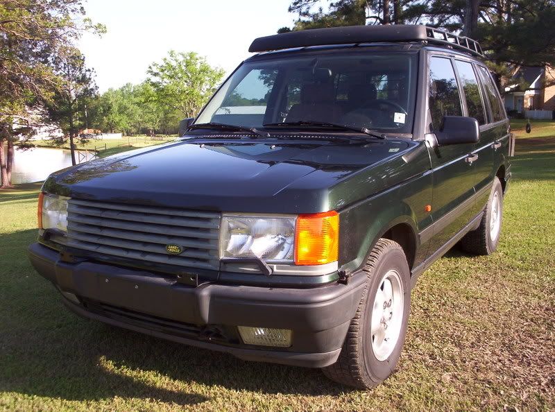

This was the day I bought it.

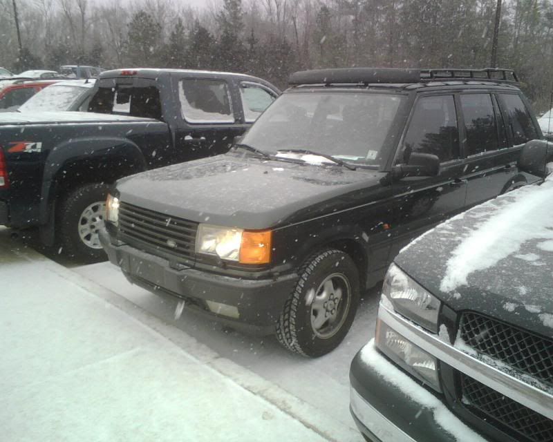

Performed well in the snow, even with street tires on it.

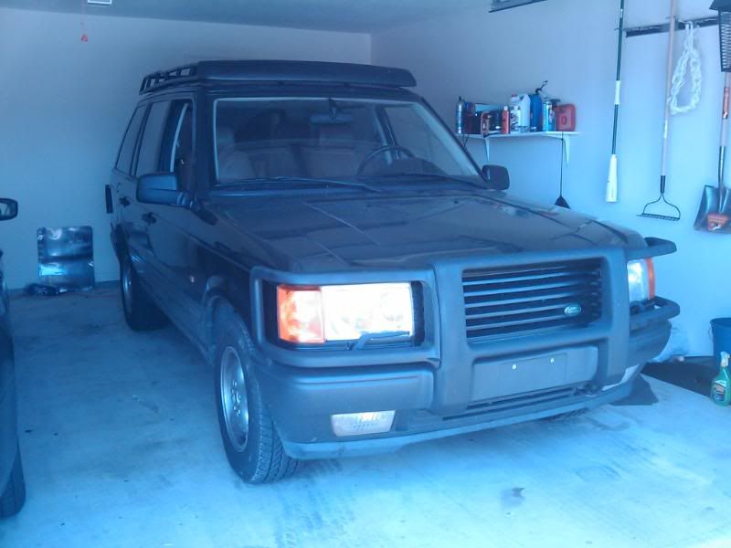

Luckily it came with an SD rack on it, but I had to track down a factory brushguard.

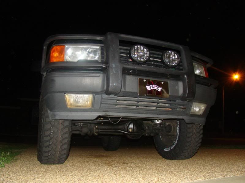

It was already converted to coils, but I swapped in a pair of Disco springs, and then added some 2" spacers from a Classic. That allowed me to get the 285/75/16's on it.

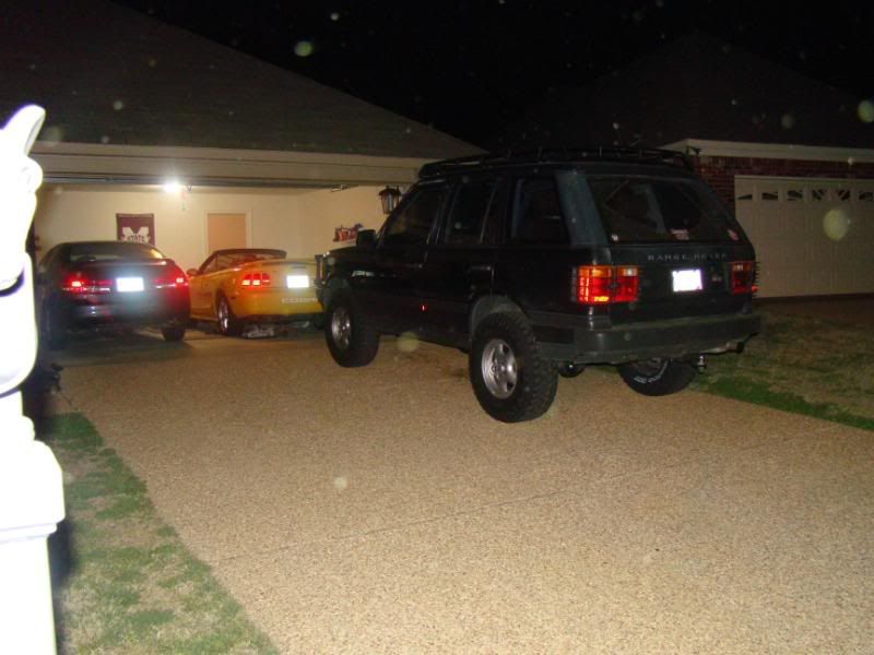

As it looks now. The Cobra sleeping in the garage is my other summertime toy. All those "floaties" are pollen,....gotta love Mississippi in the Springtime.

Looks great. What disco springs and spacers did you go with? Do you have any rubbing with those 285s?
It had the coil conversion when I bought it. I bought a set of rear springs from a Disco II. I swapped them with the ones on the rear axle, then put my old rear springs on the front. I got the 2" Classic spacers from Toddco Suspensions.
The tires have "sidebitters" on them, and if I turn full lock, they rub against the radius arms. That's the only time though.
865 Posts
There are steering stops that are adjustable to prevent tyres rubbing, I noticed your co-pilot isnt wearing his uniform which goes against RR protocol :doh:
