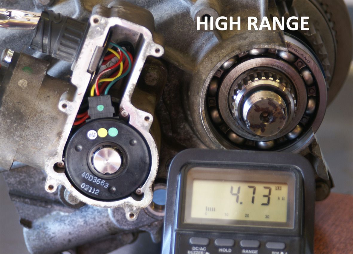

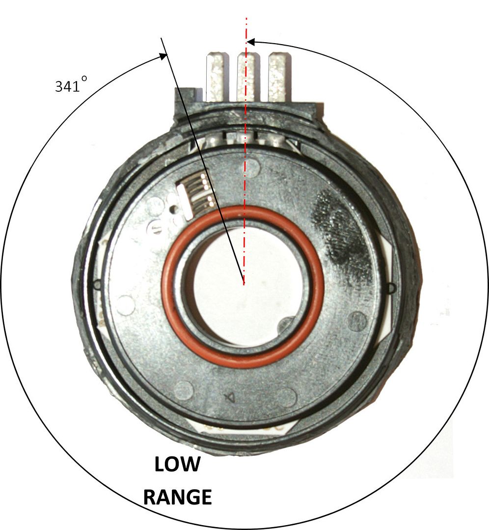

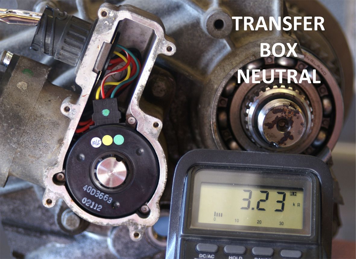

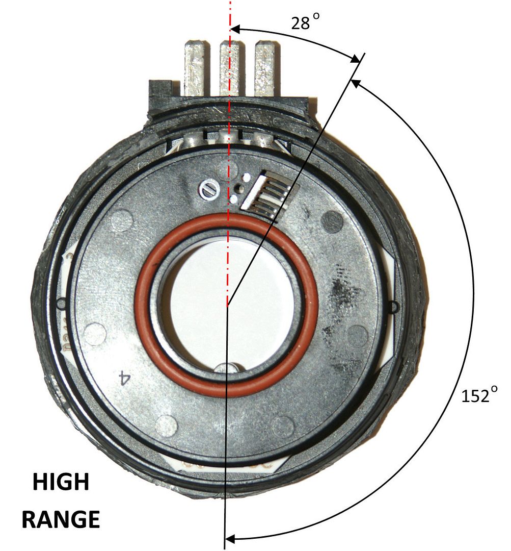

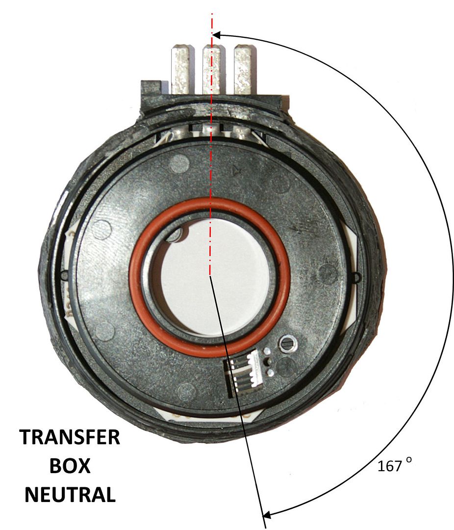

I’ve added some more information about the transfer box shift motor potentiometer below.
Regarding the potentiometer’s three electrical pins, the end pins are the supply & earth for a 5 volt reference supply from the ECU and the centre pin sends a voltage signal back to the ECU which varies depending on the angular position of the drive shaft i.e. it is this signal that the ECU uses to decide where the shift fork is and therefore which range is engaged.
The relationship between the drive key (which engages in the slot in the shaft) and the wiper position is shown below, together with the wiper’s angular position in each range. Defining a line from the centre of the middle pin to the centre of the potentiometer, in high range the drive key of the wiper seems to line up pretty much exactly with this reference line. Note that the potentiometer is being viewed from the underside (hexagon side) in these sketches :
2,378 Posts
Discussion Starter #6
The equivalent resistance measured between the earth pin and the centre pin on the potentiometer for each range is shown below, and the angular position of the slot in the shaft can also be seen :

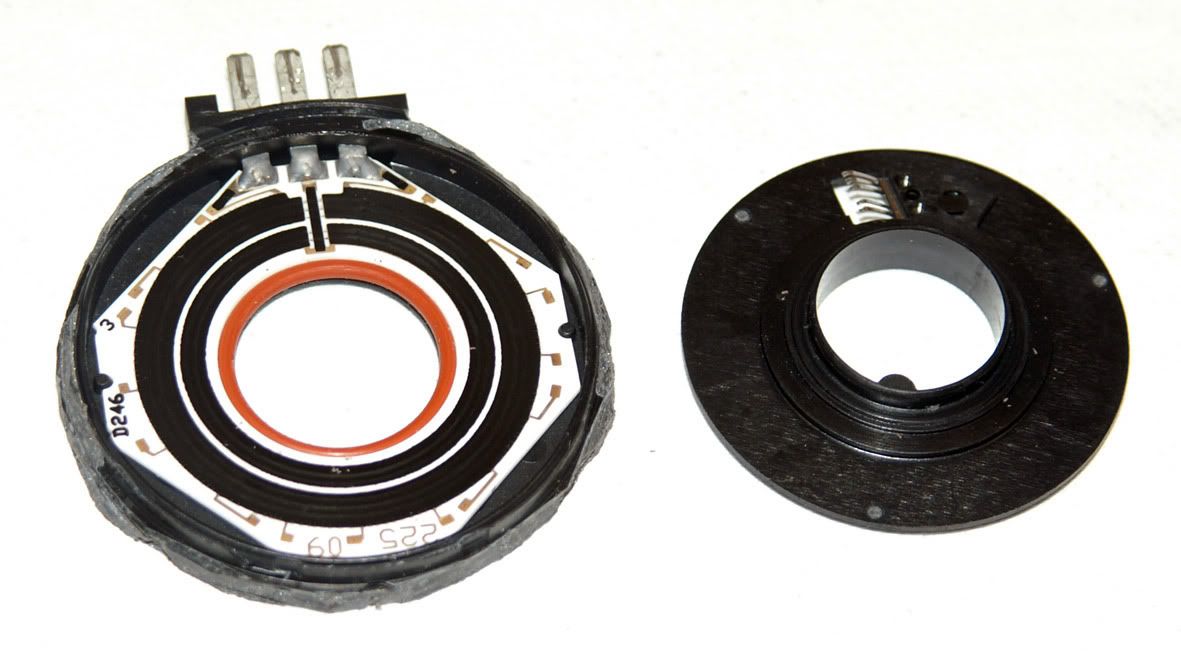

The potentiometer’s resistance at the extremes of angular movement (end pin to centre pin) are 1.26 kilohm to 4.84 kilohm on the particular one that I measured, though clearly there will be a manufacturing tolerance on this.
This photo shows the (carbon?) tracks on the fixed part of the potentiometer, around which the wiper moves taking the voltage from the ‘outer track’ – connected at its ends to the two outer pins – to the ‘inner track’ which is connected to the centre pin :
