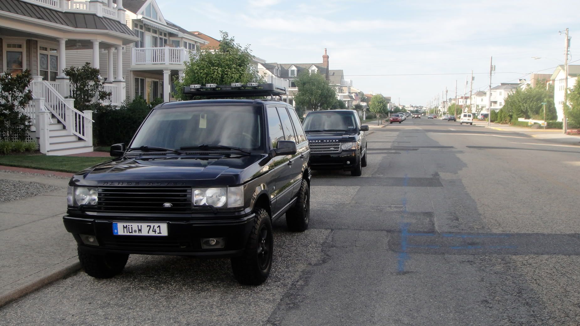

Couple new pictures before the 4th - more to come soon.
Put up a new roof rack a few weeks ago and tested it all out on a trip up to New Jersey for the summer holidays. I had the factory crossbars in the garage for years and finally decided to do something with them. I made a psuedo-custom rack out of the OEM sport bars and a Surco urban rack. It is fairly easy to take on and off as needed with 1 or 2 people. So far it has worked out great. There is hardly any noise, even at highway speed. I put a set of 4 Hella FF75 lights on the front. They aren't wired yet as I am still trying to figure out how I am going to set it up.
I have a spare BFG tire on order and a set of ROTOPAX fuel canisters (rotopax.com). I am going to mount the tire on top of the rack as well as the fuel containers. I have an additional light bracket in the rear that I am considering placing a rear flood light on.
I'll upload new pictures once I get everything else situated.
Cheers.

Looks great. Did you paint your bumpers and grille with a spray can, or have them professionally done with the body color? What size are your tires?

Yes, all of the body paint (bumpers, grill, trim pieces) were painted professionally. However, I am going to have to respray the bumpers in the near future.
Tires are BFG Mud Terrain KM2 in 255/70/16 with 25mm spacers.

I also like the architecture of the homes in the background. What address is that? I would like to build something like that here in Los Angeles.
