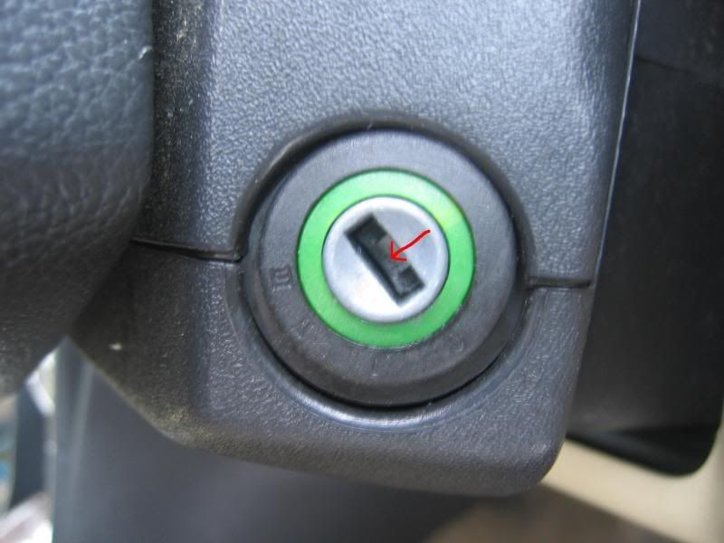

Nelson as regards ignition key just get some electrical contact cleaner and spray the ignition barrel.
As you insert the key it forces back a swith plate which tells the BECM the key is inserted,but after time crap builds up and somtimes stops the swich returning after you have removed the key.
The arrow indicates the swithplate that can stick.

hi just had a problem locking mine on the remote would unlock but not lock after reading this post sorted the problem if the display say ignition key in the flap on the ignition has stayed in as per photoin previous post just got a small screw drive and flipped it out no message now and car locks and unlocks as it should do on remote .
neil :dance:
