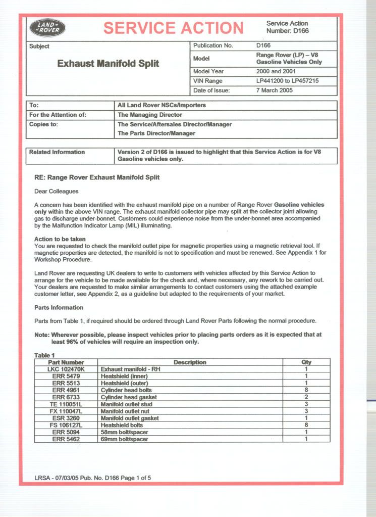

Apologies for resurrecting this old thread, but it is as close as I got to answering my question when I was searching the forums..
I also tried the TSB link to jimsrover in this thread, but it is dead. Is there a new site?
I have a 2001 P38a with a leaking RH manifold.. It would appear from the VIN range quoted in this thread that mine should be covered under recall.. The last 8 of my VIN being 1A449087.
My nearest dealer in McAllen TX is apparently useless when it comes to service bulletins - after she said 'no there is no such recall or TSB 166' she handed the phone to the parts guy who couldn't find the part # to give me a quote! I've been waiting for a call back since Thursday..
So, my question to those more knowledgeable and may have access to the original TSB, does my VIN fall into the recall range or not? If so, where do I go from here??
Thanks
Dan

Mac
Special Action Bulletin D166 Issued 7th March 2005. Consists of 5 Pages and includes a couple of photos.
Exhaust & Emissions: ENGINE AND ENGINE COOLING:EXHAUST SYSTEM:MANIFOLD/HEADER/MUFFLER/TAIL PIPE
Service Bulletin Number: 166
NHTSA Number: 10016659
Model Years Affected: 2000, 2001
Date of Bulletin: 09/2005
Bulletin Summary: RECALL ACTION-RIGHT SIDE EXHAUST MANIFOLD CRACKING.
Mac
5
Is this of any help?
Thankyou all!
Per the proceedure I will go and check to see if it is magnetic at all and if it is, I will arm myself with a printout of all this and go to see the service manager.
I really appreciate the scans of the 166 recall Col, I expect it will be pretty irrefutable when I go off to the stealership.
