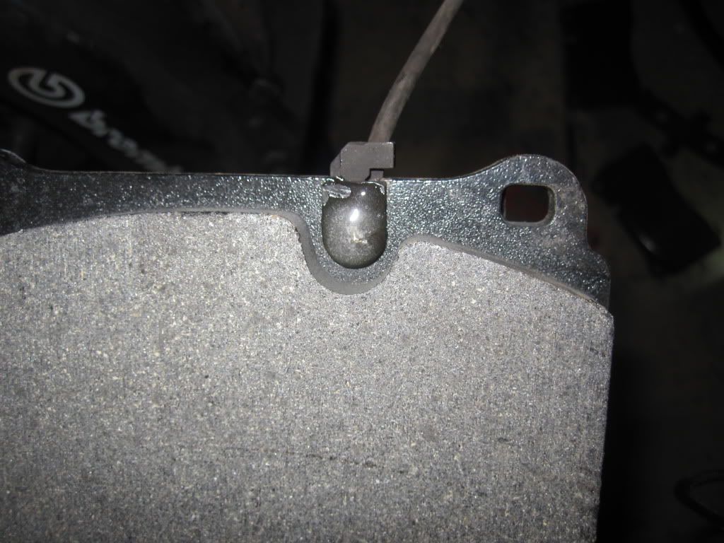

Got all my brake pads in a few days ago ($120) and put the fronts on tonight. I didn't order new wear sensors because, well, I was just going to splice them to shut up that **** idiot light/incessant dinging noise thing that happens when they are triggered. So I took the front sensor off and checked it out:
Cleaned it up:
At this point I figured wtf, why not try to repair it so I can reinsert and it'll function again when the pads wear down. A little solder:
A little epoxy:
A little reinstallation:
The infernal warning ding is gone and with any luck the sensor will give me a shout when I'm running low. My $60 front brake pads and 40Kmi original rotors seem to work just fine, too. Comments welcome, just don't call me cheap. It's *value oriented*, mmmk? :lol:

Nice Drevs! And you saved your forearm and wrist from being permanently scarred by not having to reach up under the wheel well liner to unplug the sensor. An especially nice solder of the coronal surface of that sensor as well. And for those looking to bling up the sensor a bit I suppose you could use some gold amalgam.
Unless the '06's just different, the sensor on the Brembo is very different from the stock brakes. I'm not sure a tripped sensor is similarly repairable on the HSE version.

Will solder and epoxy stand up to the heat generated during heavy braking?

Yeah I didn't trigger the rear sensor yet, so I don't know what it looks like. I took the rear pads out and there was still plenty of meat left on them... I decided to use them up a bit more before replacing them. I need to wiggle that rear sensor outta there though, so I don't have to do a repair on it too when those pads wear down further.
I guess we'll find out eh? :)

So far I have 14 miles on the new front pads. They're fine, braking power is good, but not as grabby as the factory pads. I think they need more time to bed-in before I'll get an accurate feel for them. So far, so good. I got them from Atlantic British. The were 59 bucks for the front pads (4 total). Just look for the least expensive ones :wink:
