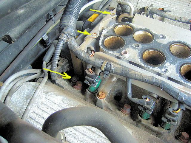

Yes the top inllet has to come off to get thecoils out. They are indeed at the back of the engine held on by 4 bolts, two of which are well hidden with the upper manifold inplace.

w/o pics, It's kinda hard, but here are the steps.
Remove hoses connected to:
Intake hose
Throttle body
Remove harnesses from the intake manifold:
coolant line
engine harnesses
Remove 6 bolts on top of the intake manifold.
Now, the above is not complete, but as you go through it, should be obvious as what needs to be done.
BTW, if you're removing the intake manifold, make sure you've purchase the intake manifold gasket.
Regards,
Theo,

I also found some photos as part of an engine rebuild.http://paulp38a.com/99p38a/engine-refresh/
great for details with photos. thanks for that overview though. I definitely won't be too worried about changing it out. Looks like a universal socket will be helpful to reach those bolts in back.
