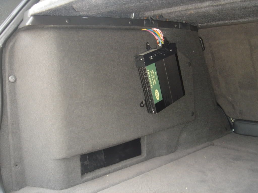

Dude, where the heck is the DSP Amp, I thought it was on the back of the sub, theres nothing back there, or is it behind the carpet??
the sound panel behind the subwoofer comes off as well. it involves putting the seats forward and gently prying off plugs on the load space cover and removing that. a screw here and there. then you gently seperate the furry layer of insulation behind that, unbolt the three bolts holding on your dsp amp and unplug it. i'm taking the amp to the above mentioned shop for a test. in a way i hope it's the amp for closure...

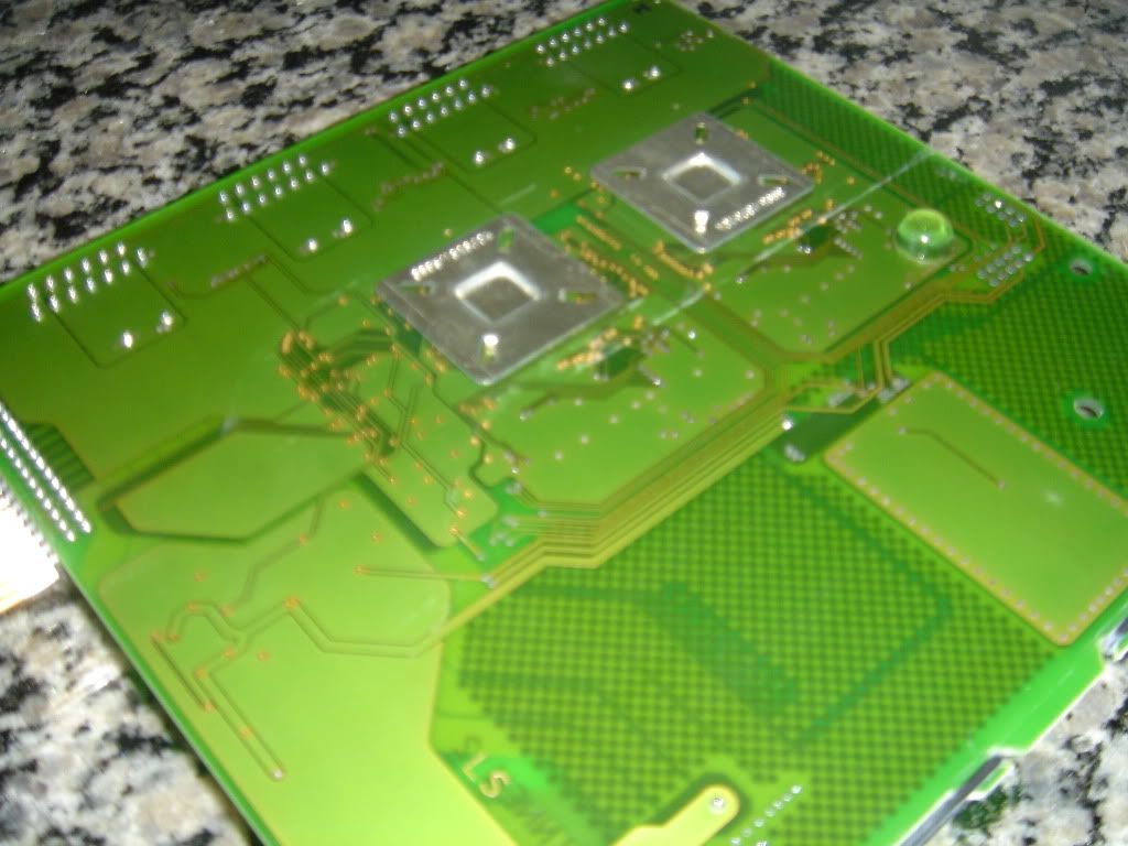

Dont know how and dont know from where but I have manage to get the DSP AMP out and apart and discovered faint traces of water running directly threw the board. Only when held up in certain light do I see the Particles left from the water that dried on the amp. Now, to be ignorant for a second,,,,

I will attempt to clean the board with contact cleaner and see what happens from there.
Its nice to know why now
The light gray strip is the water
all the way to the bottom

I sprayed the board in contact cleaner, actually I used MAF sensor cleaner and lighty wipe it with a paper towel and OMG MY SOUND IS BACK
:crybaby2: :crybaby2: :crybaby2: TEARS OF JOY LADIES AND GENTLEMAN
To everyone wondering why the DSP amp goes out I believe this is the cause, someone how water is getting into the unit. Mines is a perfectly kept never been wrecked range and for whatever reason, the water was there. I will be mounting the amp in a different place right now, I leave it to someone else to find where the water is in from. Also, there is no water or mildew smell in the car. just that very faint small stream on the board.
