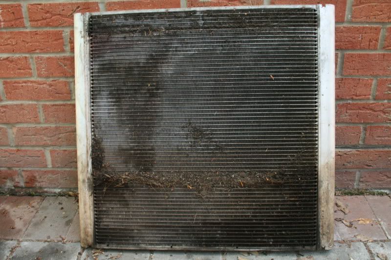

I replaced mine a couple of weeks ago after spending the last six months constantly having to top it up. One side was partially blocked with mud/leaves etc the other shows an obvious area where the leak was.
