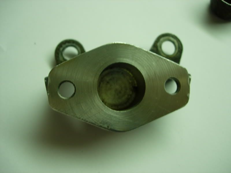

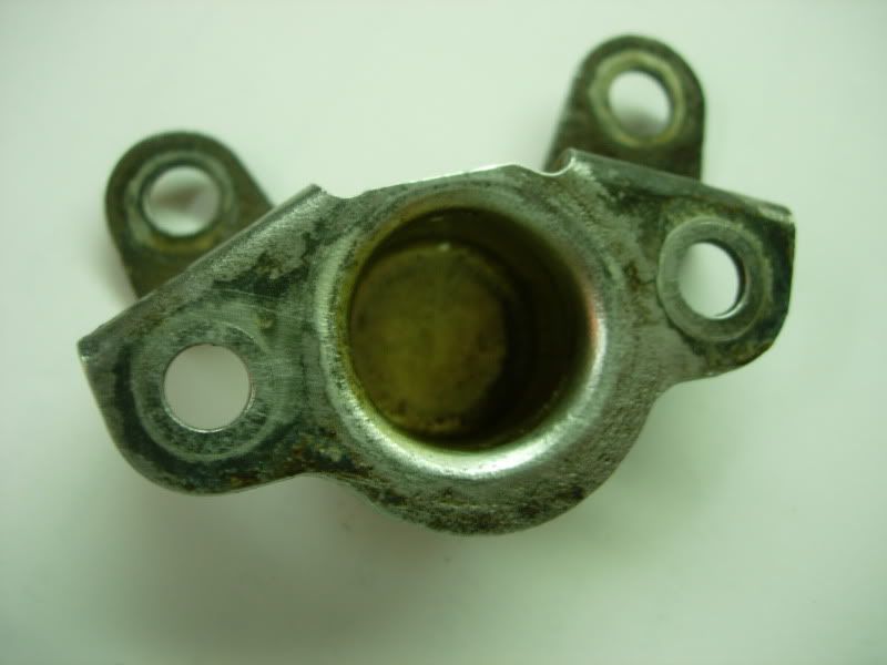

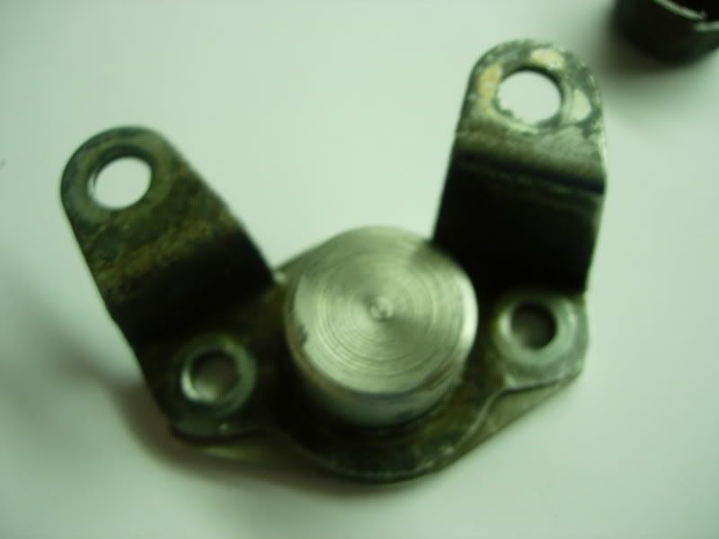

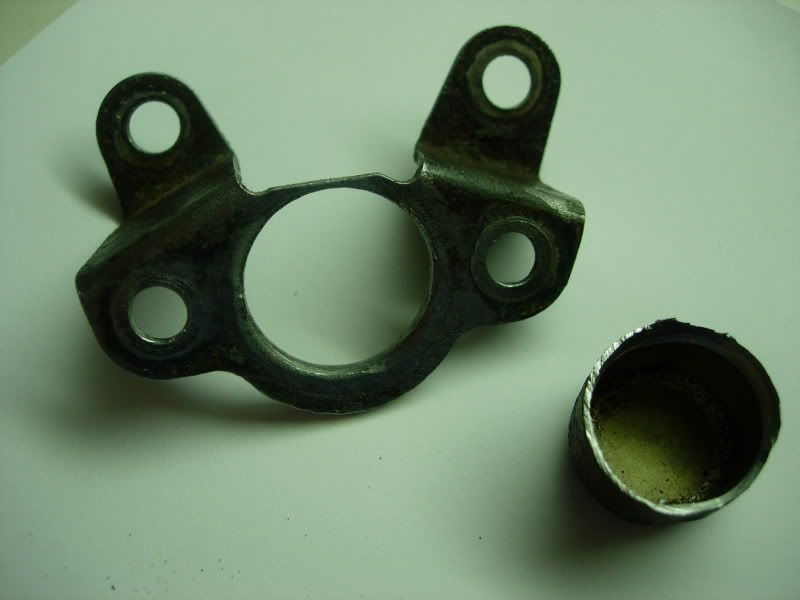

Due to the construction of the cap of the PCRV valve of the braking system the rubber o-ring is pushed outwards over time at the edge where it is not fully pressed down by the cap causing brake fluid to leak out. This PCRV valve is according to the WS manual a non serviceable item. I replaced mine with a new unit but I took appart the old unit and machined a new cap (with the same internal dimensions as the old cap)which I placed in the drilled out old cap before fitting it back with a new EPDM o-ring (ID is 22mm and 2 mm thick). This modification makes sure the problem will never reappear.
There are two cars in Malaysia now driving around with these modified PCRV valves for over 6 months without any problems.

The valve is limiting brake force towards the rear brakes and is located next to the brake booster unit. On the RHD verhicles it is under the coolingwater expansion tank.
The edge of one part of the cap is very small and over time and because of brake fluid pushing from the inside the o-ring slowly is pushed outwards and brake fluid starts leaking. The cap is used to keep the spring under pressure inside the valve so be carefull when opening. You need a special torx bit with the hole in the middle to take off the cap.
