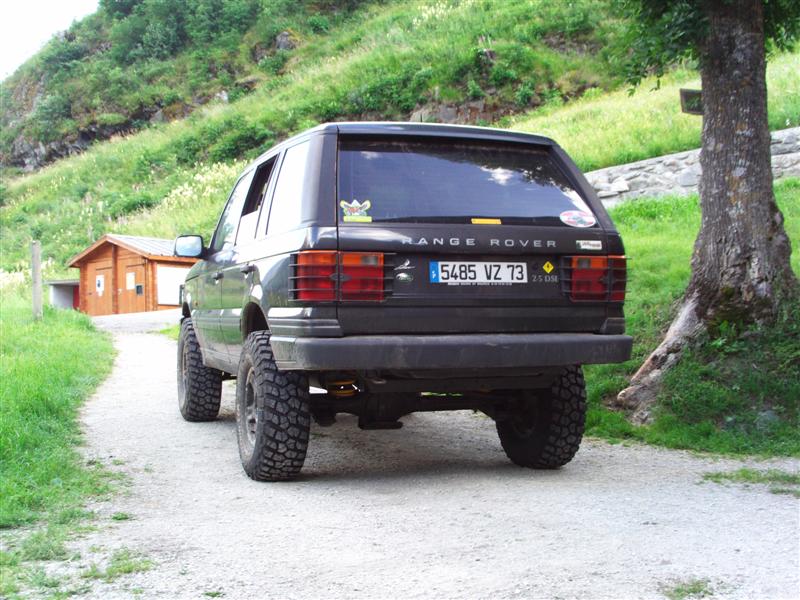

WOW!!! That's some machine!
Will that size tire fit in stock form with air suspension?

rogan said:
What springs & shocks have you got now?
Hi !! for the springs, bearmach BA2103 on the front and Britpart DA4197 on the rear, for the other parts, I put this :
and the result :
I need now adjustable panhard rods !! I don't have in france :crybaby2:
regards

DAV P38 said:
and the result :
regards
Nice!!!
What size are the tires, shocks and the drive-shafts? Can write down some numbers?
Thanks,
Bernard.

Is there much drive line noise from the Unijoints complaining about the angle they are on with the lift?? If I force the White Peril into extended mode (and maybe a little higher 8~ ) she tends to get a little noisy..
