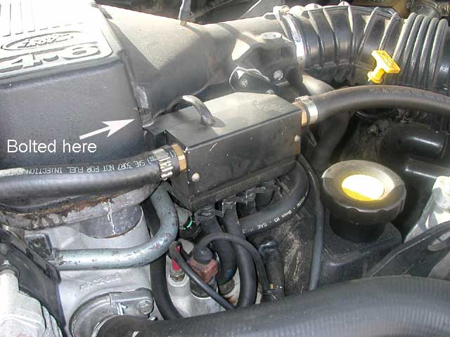

My vaporiser is on the left, behind and below right of the EAS.
The ECU is near the battery.
The injectors are on brackets bolted to the plenum.
5
and from behind:
