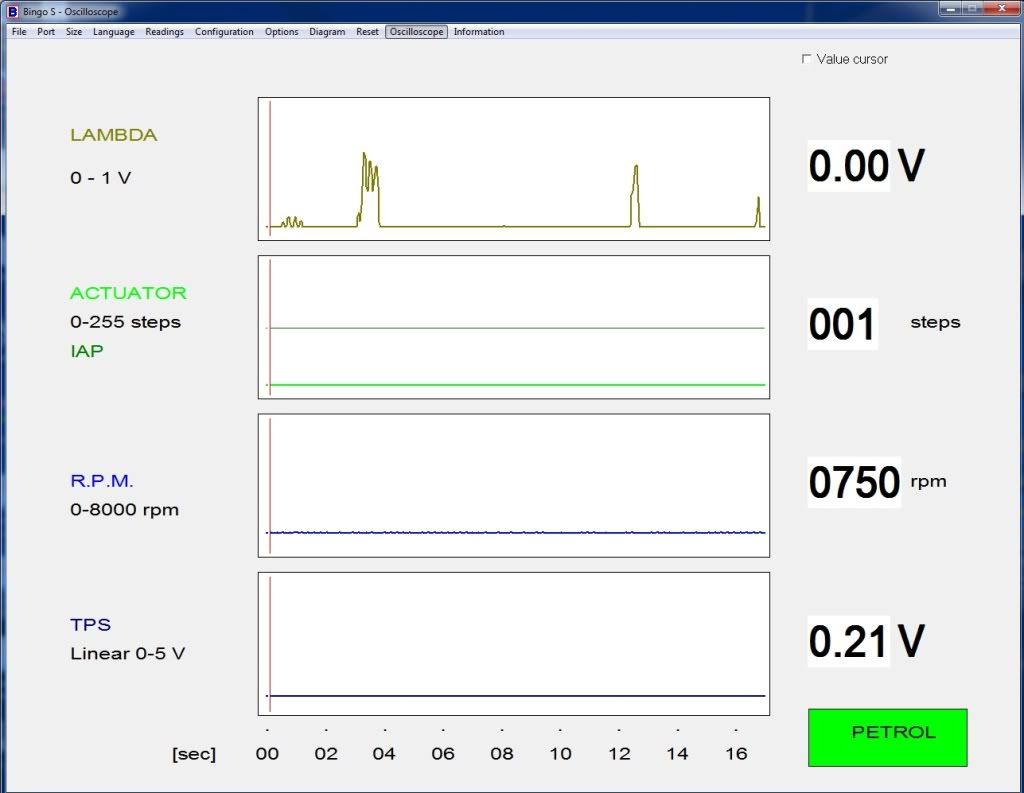

Sorry for not posting the resolution to this sooner, i had completley forgotton I asked the question on here.
Aparantly the vapouriser i had on it was only good for "up to 190bhp" so it was too small even for the 4.2. I now have a bigas high flow vapouriser from tinlytech which is great. Between that and buying the leads to re-configure the LPG ECU so it fules my new lump correctly it is like having a turbo charger fitted compaired to it's previous configuration.
My current issue which nobody seems to understand is this:
ECU readouts:
petrol at idle:
lpg at idle:
petrol at 2500rpm:
lpg at 2500rpm:
Both lambdas read the same. Does that look like i have a pair of poorly lambdas or do they look normal?
4
I assume you have a stepper motor controlling the LPG at higher rev's in order to maintain efficiency, and I would just assume it takes longer to adjust than the EFI ECU. Its simply regulating the the fuel flow to keep the engine at the lean/rich midpoint. Typically theres a stepper motor which reduces LPG flow untill the O2 sensor readings shows the engines running lean, then the stepper motor opens up untill the O2 sensors show the engines running rich, and the process starts over again. The EFI ECU does the same thing by adjusting injector timings.
I have a small stepper motor on mine and at revs I notice it only cycles about once a second from lean to rich, so yours is faster than mine.
