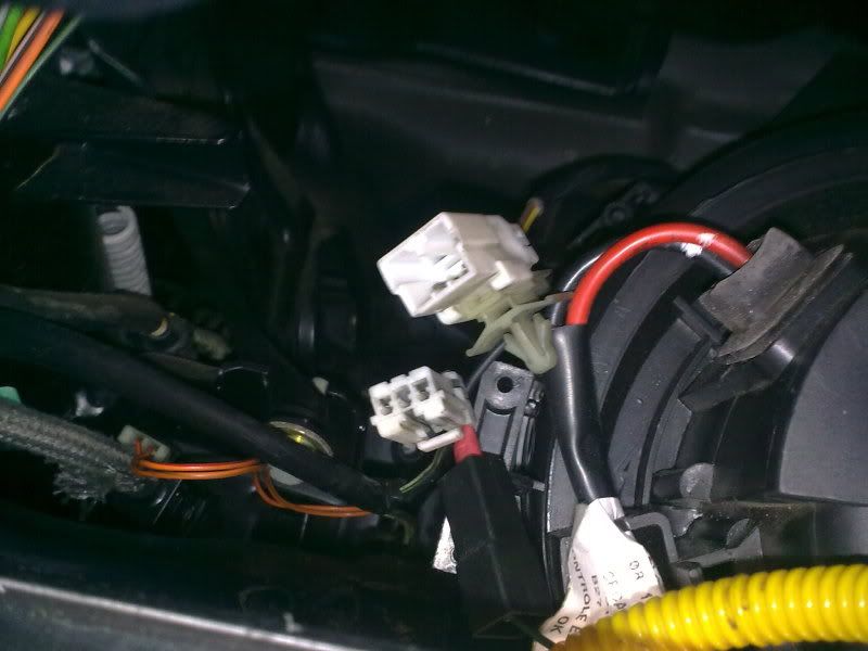

Hi
As promised a photo from the connectors. The connector that is from the blend motor is clipped to the top housing of the fan.
My car is RHD so it is a photo of the right side footwell and blend motor is fitted at the outside. If your car is LHD you find a similar connector at the left side of the car. The colour is white.
Regards
Jos
Hi All,
I have just opened this connection on my left hand drive RR and the banging noise when starting the AC has stopped.
Quick fix! :lol: Thanks for the tips in this thread.
