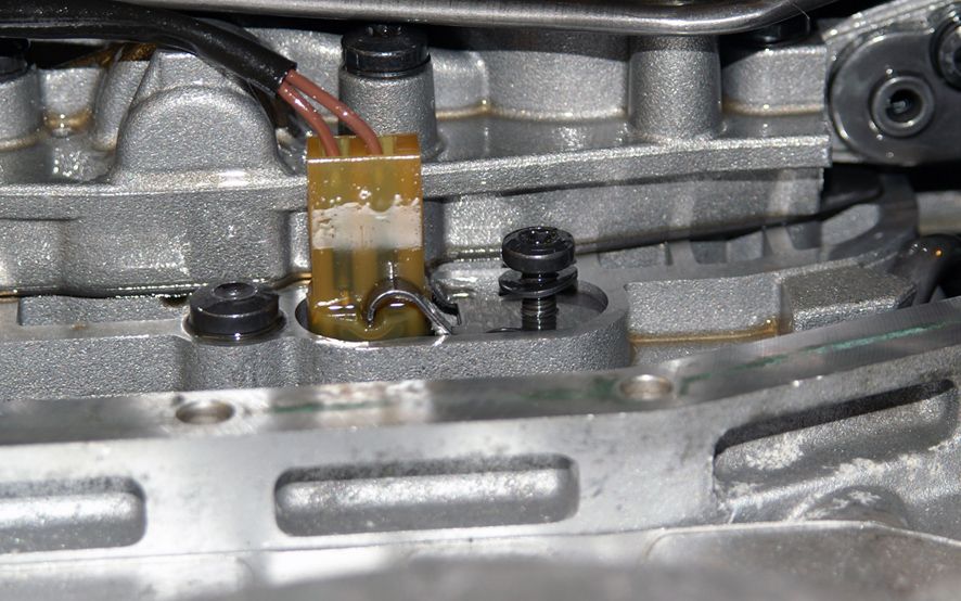

Interesting that you’re flagging an error code for the turbine speed sensor, yet your resistance measurement shows that it’s connected okay
I wonder if it’s worth checking that the retaining screw isn’t coming loose? (though why this would be temperature dependant I have no idea)
You could inspect it at the same time, just to make sure that the sensor end (which is magnetic) isn’t contaminated with metallic debris

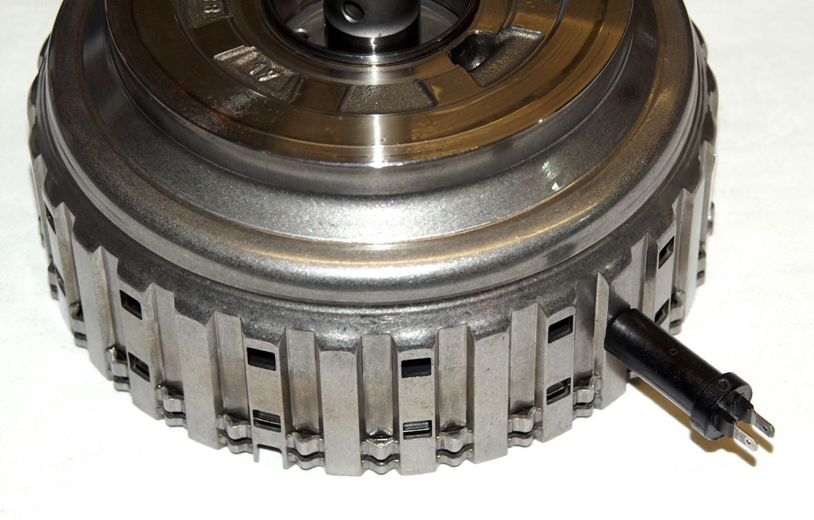

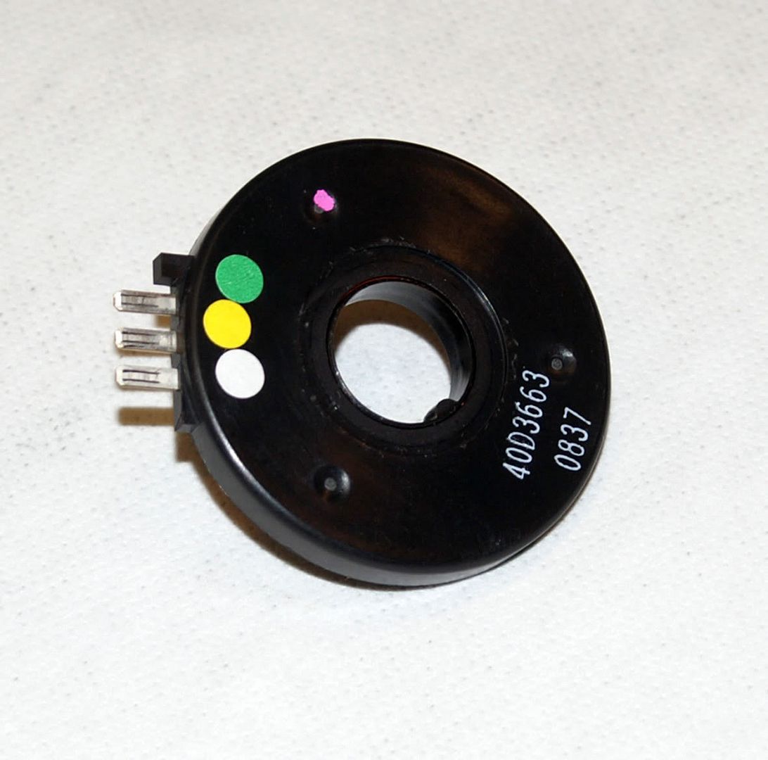

HI Phil. I only noticed this morning that the switch in your image looks like it is inside the gearbox (need to remove the gearbox oil sump). I will only be able to do this 2 weeks from now. (I've opened this gearbox so many times in the past 3 months to test stuff - might be a good idea to get wing-nuts for all those sump bolts :) )
While under the car I removed the below censor, which is on the torque convertor, but it "looks" fine - not sure what the resistance needs to be

Hi Phil, do you maybe have a part number for me on the turbine speed censor ? I’m just going to replace it, seeing that I have to open the gearbox to get to it.
Maybe this one :
Speed Sensor 5 Speed AutoPart No. STC4444
Thank you
2,309 Posts
Because the ZF 5HP24 transmission was used by BMW, Jaguar and Land Rover, all of these are part numbers for the same speed sensor:
ZF = 0501 310 401
BMW = 24 34 1 218 551
Jaguar = JLM 11251
Land Rover = STC 4444
The input (turbine) sensor and the output sensor are identical, so there are two per transmission.
Yes, the ‘noise on actuator signal’ error code is normally associated with a faulty transfer box shift motor potentiometer.
Phil
