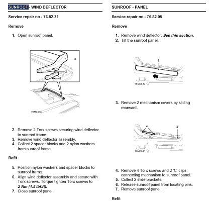

In reading the RAVE CD, i can't tell if i have to remove the whole headliner as a prerequisite to
removing the sliding sunshade. Only my sunshade fabric is turned loose, so it's all I want to remove.
If someone can write a quick overview of the simplest way to remove this thing that would be
great, I can follow the exact details in the RAVE but if there's an easier way to achieve my goal
please let me know!

Super easy, requires a dry working environment and about 90 minutes for a rookie. Follow the directions in RAVE for removing your glass panel. Once the panel is out of the way, and your hands are super clean, the sunshade will come right out. Save the four sunshade glide clips in a bag and do whatever with your sunshade. I know a few folks that have simply left the sunshade out because they never use it. If you are having your shade recovered just replace your glass panel as in RAVE. The shade has a big zero to do the with sunroof. In other words you can take your time putting it back in.

I did it without removing the glass or the headliner. Took about 10 minutes. Gave the headliner to a shop and they recovered it for 80 dollars and I popped it back in without an issue. Key is the slide shade is "flexible".

no. if you take the time to read the directions you will see why.
How 'bout that... the glass comes out the top.
