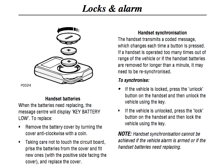

Guys, my key fob stopped working and I replaced it with new batteries and it still does not work.

I took this from Page 31 of the 2002 Owner's manual, courtesy of the RAVE cd. Hopefully synching the remote to the vehicle again will solve one of your problems. Good luck!
