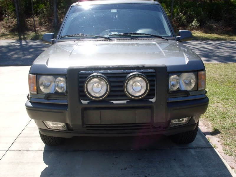

Just wondering if people could post pictures of their extra lights they have fitted.
Preferably from the front and looking down onto the toop of the bumper.
kmagnuss,
did you fit those steady lamps ? Can you provide pics from the inner mount points (behind the grill) ? any tips are appreciated.
I've been looking to add some to my rig, since those Safari 5000s shake quite a bit.
Are these the ones you have ?
http://www.roverparts.com/Parts/STC8814G.cfm
N.
Yep. Those are the ones I have, and yes I installed them. Once I figured out that I had to cut about 6" off each one to get them to fit it was an easy job. Just a drill bit to make the holes in the grill, and some self tapping screws to fasten it to the area above the grill. Remind me tomorrow via pm and I'll get a pic of it. I'm drinking and I know I'll forget otherwise.
