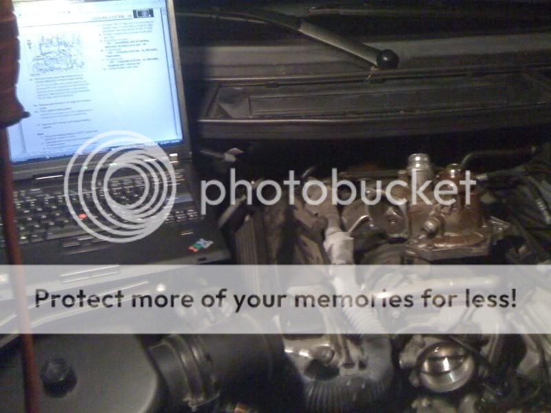

If you go with a off brand water pump, throw the gasket in the trash and pickup the OE gasket. That being said the rest of the $49 dollar unit seems higher quality than the $300US OE pump. The internals look much more stout compared to the OE pump.
Busted pump ontop of the motor, it spewed nasty brown coolant all over the engine bay, you can see where it was coming out of the snout of the pump

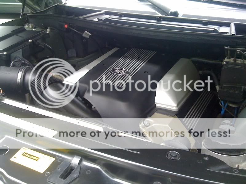

Cleaned everything and reassembled. :dance:
