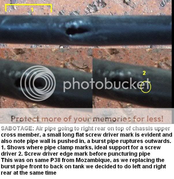

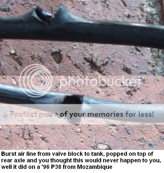

Exhaust hole on rear section where it bends up and around axle like to burn through, heat builds up nicely where the pipes for tank and right rear pipes run on top of cross member, this heat then softens up the plastic pipes but the tank supply blows first as it carries more pressure
Happened to a customer from Mozambique but numpty here didnt pick up holed exhaust, definetly worth placing a deflerctor pipe on exhaust in this area cos all exhausts pipe rust through and it dint even sound like a blowing exhaust does.....
But the below pic is obvious sabotage
