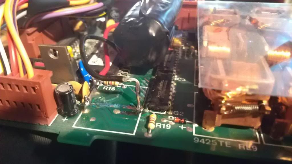

Hello world,
I'm new to this forum, ;-)
driving a 1995 Classic RR, I had the seat ecu memory not working anymore, over a year ago I took the whole unit out, and had it in my livingroom until enough dust covered it.

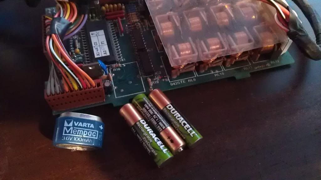

Well, a few days ago, I thought I'm gonna finaly order a new 3.6V battery, the blue little Varta one.

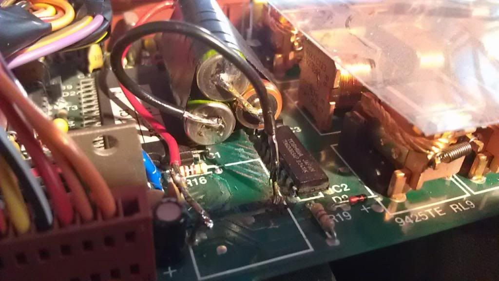

I soldered the old battery out, and then thought, why not just replace the old battery with usual NiMh batterys?
I found three 1.2 Duracells and soldered them together. See Pics:
Putting every thing back under the seat, I ran the calibration (Handbrake, Ignition on, press five times the green button, following 2112), see Video.
Cheers, Chris

well, it worked for about 60km, then I smelled soldering and when I was back home I opened the box, and the red wire was disconected. I don't know if it's because of the 800mAh instead of the 100mAh from the original-battery, or if it's because of the corroded IC's... no idea.
It's Land Rover, you fix a thing and then it works once or twice. Had the same with the Cruisecontrol, fixed it, it worked one day,since then, kaputt :?

The issue is that you put a NiMh instead of a NiCd. Don't mess with stuff you know nothing about ;-) They aren't compatible from a charging perspective.
Get a replacement button cell on ebay and solder it into place.

Hmmm, I wanted to order a battery like this one
It's written NiMH on it, that's why I thought I could take NiMH batterys and tryed it this way before ordering.... Good thing I didn't order the Mempac, it wouldn't work in the ecu /:(
