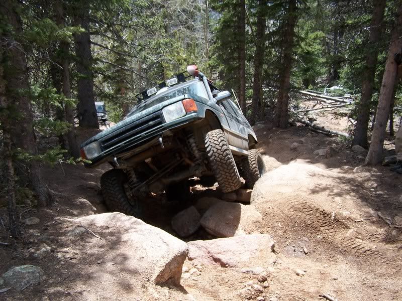

That rig is for sale right now. I think he wants 6500.00 It has 4.11 and ARB's front and rear, bilstien bypass shocks sitting in the box.

those look like simmerlar size wheels and tyres that are on mine, mine has a 4" lift though, I've been trying to find out how to stop the tyres hitting the wheel arch edges and the radius arms. Did he have this problem?
Front wings are not a problem, there isnt really anything behind them so i could cut some away from them, but with the rear door being part of the wheel arch I'm not sure i can cut enough away without having a hole in the cabin. Stiffer springs or shocks would cure it i guess but that involves alot of money and I quite like the amount of articulation my rig has got.

Longer rear control arms, basically extending the wheel base and inch or two is the right way as well as taking a 1/2 inch off the door sill, making sure not to wreck the door seal. That's the big problem with coil suspension systems. the arc they move in causes them to "tuck as they flex" or "drop".
I like my leafs on the Jeep as they increase the wheel base as they flex. Not a great ride on the washboards but durable and unbreakable (almost).
