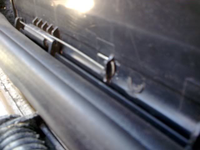

Here are the pictures that I promised. It might explain better what I did.
The left spring.
The right spring.
They have held up for the last 2 months. I don't think glueing the broken bits back with superglue or any other glue would help. Plastics used in modern cars don't seem to be glued very well.
