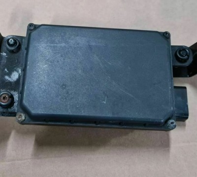

Parts needed
Luckly it’s a short list. Bad news is the cheapest I found the Radar Sensor was 1500.00 for a new one. I see used ones for 500-600 but the two I tried to buy flaked out. Also GAP recommended a close match as possible in year and model for success. The actual ACC system is a Delphi system that they sell to other manufacturers as well. Mostly Ford. So there are a lot of those sensors out there for 200-350 dollars but... there’s different firmware versions loaded on them and I’m not sure what is cross-compatible.... So there is an opportunity for the brave that has the time to fiddle.
Also the button pack looks a lot like the non ACC one just with arrows. Same number of pins etc... if I was a betting man I’d say that one would work. But then you wouldn’t have the cool arrows to show off to your friends that don’t care. Also brand new it’s only about 75 bucks and I wanted to keep variables to a minimum.
LR062658 - Radar / Distance Sensor Unit
LR060076 - Radar mounting bracket
LR087486 - Steering Wheel Switch Pack
here is a picture of all the parts listed on the diagram. You don’t need the foam block unless you have a small pet that needs a pillow.
283776
This is the Radar Distance sensor
283777
Here is the bracket for the sensor
283778

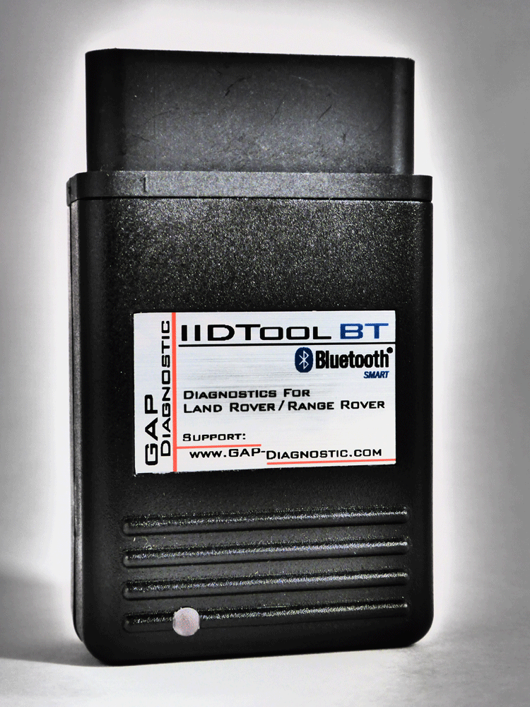

This required some trial and error as no one had a guide. Using the GAP IID tool you’ll need to email their support and tell them what you want to do as they have to unlock the “Full CCF” function. This gives you access to all the CCFs they have discovered. Once you have this power there is a chance you could mess something up if you go through and randomly change settings. Most items have a logical name but the full effects may not be known as many items interact with others.
For ACC you need to change 11 items, most are pretty clear:

So being the first go I bought all new parts for the best prices I could find online. I spent about 1700 not including the GAP tool. I think if you are patient and waited for the right used sensor to come up for sale you could do it for 700 plus the tool. If someone cracked the code on the Ford sensors you could do it for less then 500.
I‘m sure there’s other ways to complete the programming /calibration besides the GAP tool, I just don’t know the exact path. Maybe an independent Land Rover repair shop would have the right software? I don’t think a dealer could help you even if they wanted to. Their tool references your vin and if you don’t have the option it won’t let them do the programming. Which I don’t blame them for liability reasons. There may be work arounds but again I don’t know what they are.
That said if you tend to tinker with your Rover the GAP tool is very valuable in many ways besides this.
I have a 2016 Supercharged Dynamic. The tool does not support 2017+ as far as CCFs are concerned.

From what I've seen it looks to be a straight swap. The plug in the back is the same and in the same location. Used they are only around 400 bucks on E-Bay.
I'm using the regular one. They only sell the Bluetooth enabled ones now.
Its actually a buck cheaper on Amazon
Pro is only if you want to do more then one vehicle. The regular one locks to your VIN. It will do code reading and minor stuff on any Land Rover Range Rover but can't adjust ride height/perform module calibrations/Modify CCFs/etc... on anyone besides the one its locked to.
