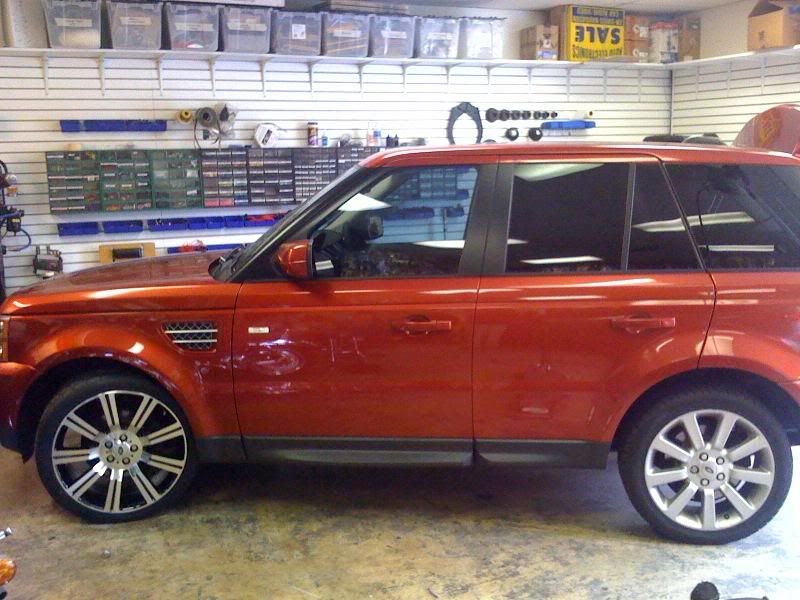

I had 20's on before i switched to the 22 machine faced stormers. bought them on ebay and the were 22X10 ET50 wheels. My lugs fit just fine. Put 285/30/22 Nitto tires on and it looks bad ass.
Also I put on the locking lug on each wheel to prevent theft...you might want to do that.
here's a pic of before (rear wheel) and after (front wheel)

NIIIICE Quite a difference, Red Rover -- are those 285/35 or 285/30 ?
I'm looking for those exact wheels except I want the parts that you have painted black to be silver.
Who did you get them through, and what did they end up costing ? -- Would you recommend your supplier ?

They're 285/30/22's Nitto 420S tires.
They look BADASS. Got them from Ebay from "eurowheelspecialist" for $899 + $150 shipping. he's in CA.
but he knocked off $100 because they got caught in customs coming off the boat so they were $949 shipped. The tires cost more!
GEt them bro. They look awesome!

looks great from that side shot--just like the one that LR used in the original concept!

I don't get it, whats hte idfference? the front is ur new ones ur rear is the stock old ones?
