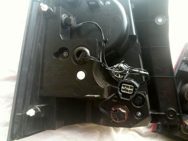

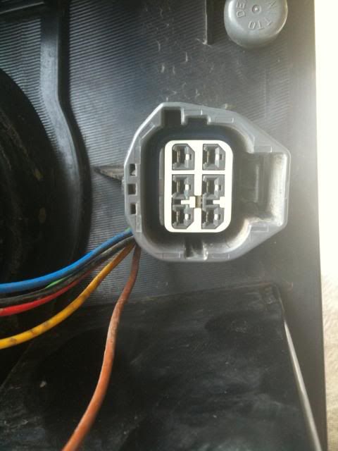

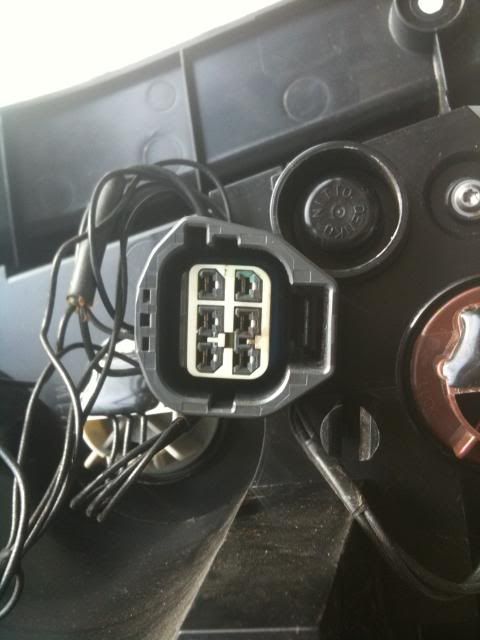

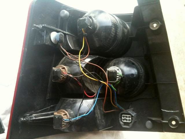

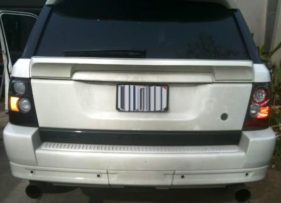

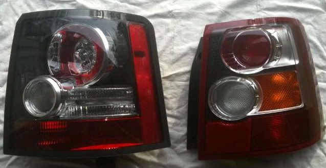

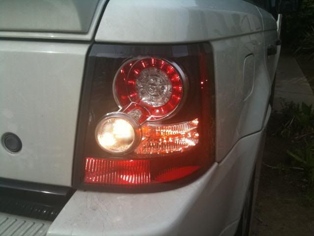

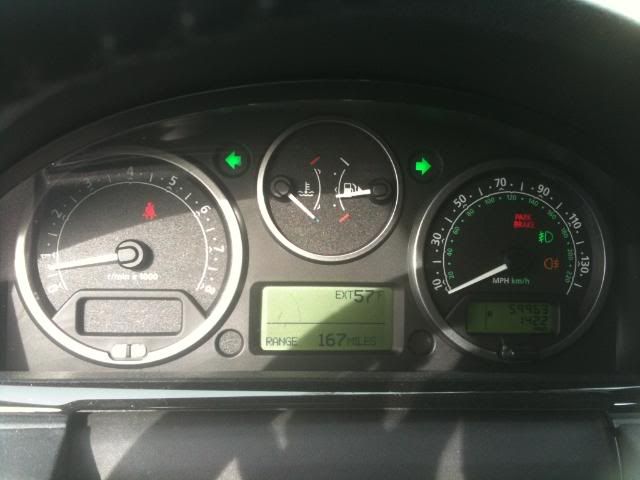

So a friend of mine had one of 2010 tail lights warrantied so i got it from him and tried it out. It fits exactly the same, works almost exactly the same and the only thing different is when you turn on your left or right blinkers you get the fast blinker warning from the car thinking the bulb is out. If you can live with that then you certainly wont need resistors. Here are some comparison pics for everyone to see.
Stock tail light
2010 tail light
06-09 plug
2010 plug
both lights on my sport
all tail lights on
Dash so you can see theres no errors
