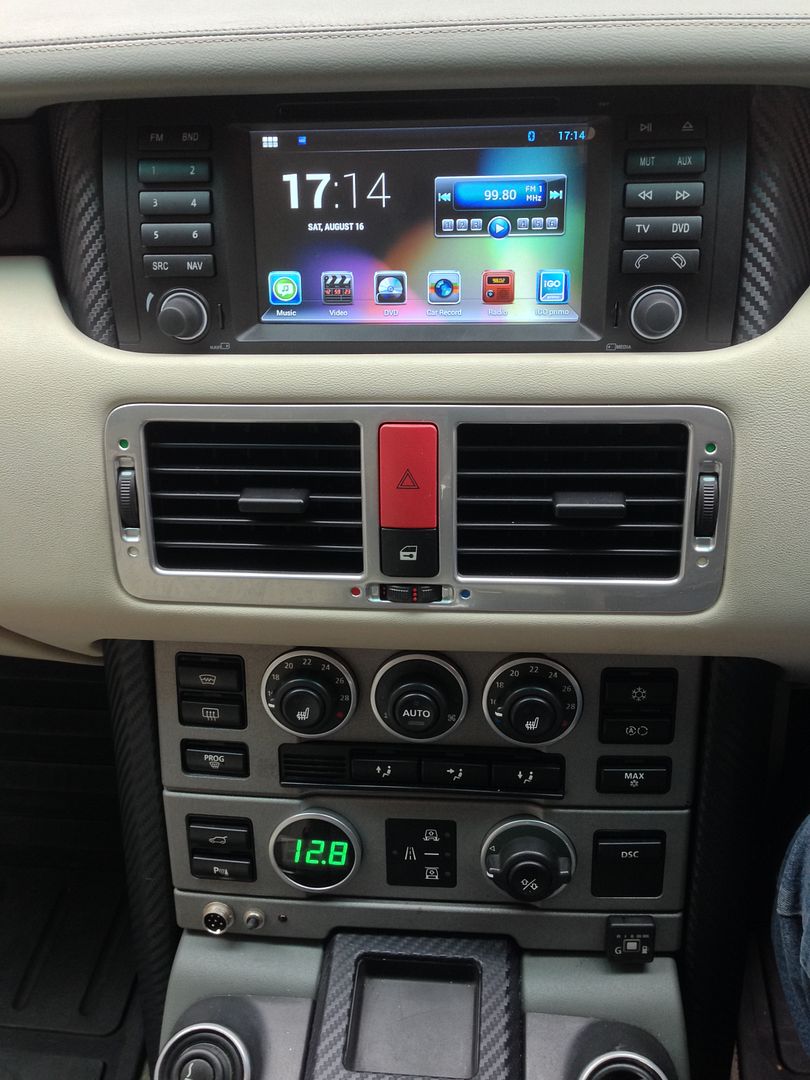

I needed one with a built in amp as I've wired it in directly to the speakers, it does come as plug and play but this plugs into the radio socket so the amp has to work to get any noise...
Was straightforward to fit, had to trim some plastic off the dash cradle to get it to fit right but nothing too taxing, ran the lead to the rear, also had to buy an aerial lead and a fakra adapter.
The steering wheel controls work great and you can customise them if you want different functions.
The night time illumination was taken to the can bus box but didn't work on mine so I wired it directly to the lighting circuit and it works fine now..

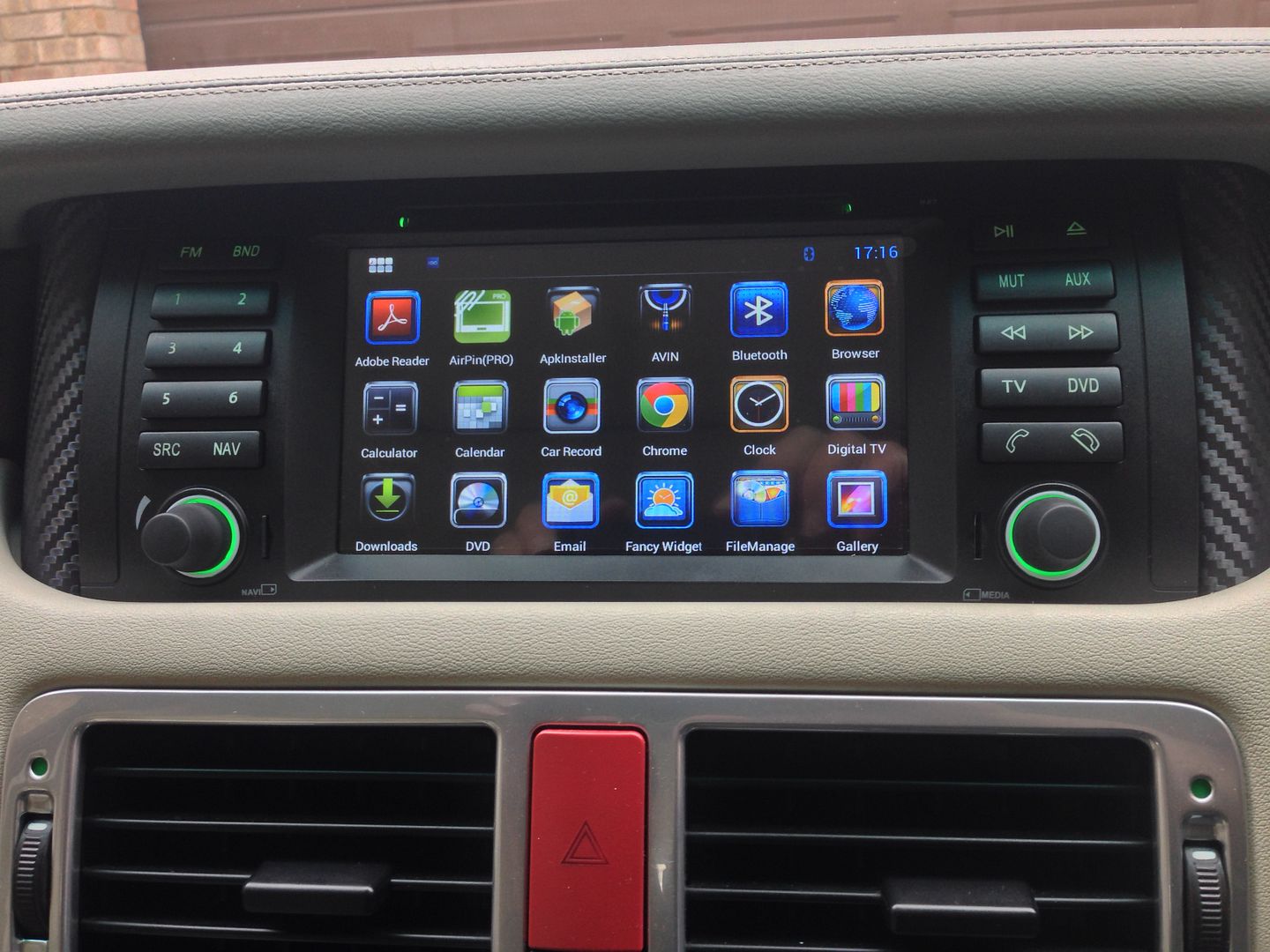

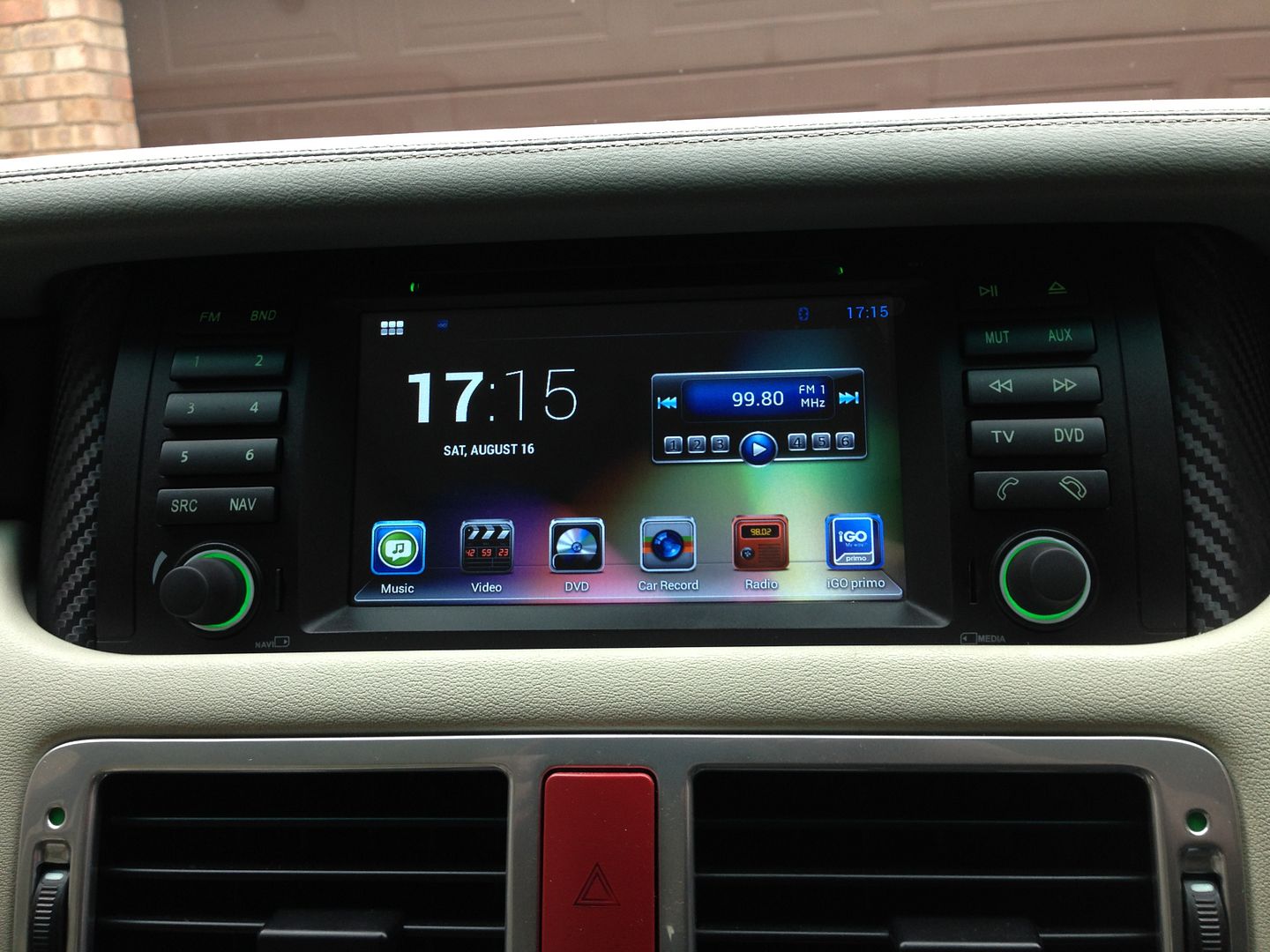

I must say it is very good, the 1.6Ghz dual core CPU is very fast and button presses are instant (this was a failing with the earlier ones, you had to wait about a second for any response)
The brightness and clarity of the screen is excellent, and being Android based you can have just about anything you like on it....
Just thought I'd let people know how good it is if they are thinking of getting one..

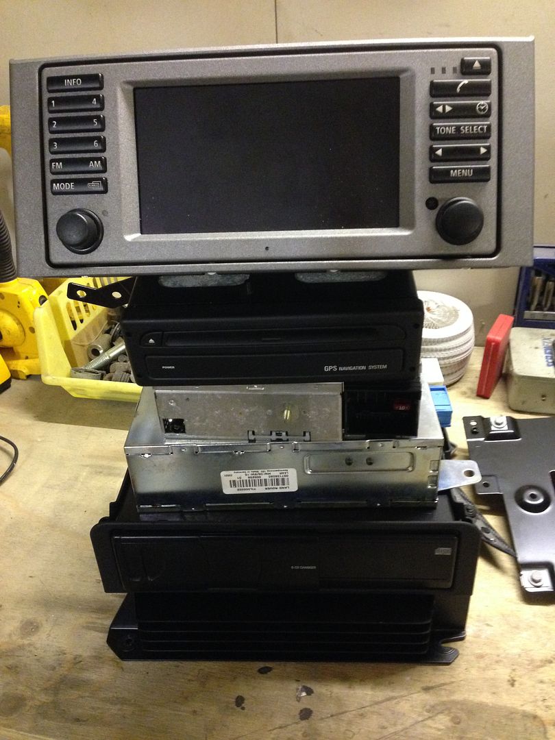

Basically you rip out all this
get the soldering iron out, well you do if you did it my way... and you end up with another large cubby hole in the boot and this in the dash

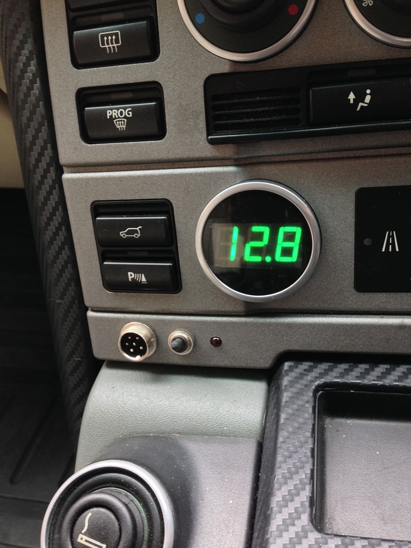

I never used the analogue clock that was set by the old head unit so I decided to replace it with a voltmeter... managed to get a green one to match the dash lights, removed the innards from the clock and fitted it behind the original front.... The head unit has a clock on just about any display and I've still got the one on the gauges as well

I know a lot of people will probably not like the voltmeter, but I think its a really good idea and a nice neat installation of both the meter and the head unit.

It will stream music from your phone, but stick a 32gb mini sd card in it and I can't see the point...
It will do two things at once, it has AV out which will play a DVD for the kids in the back while you listen to the radio....
Does your 2006 have the fiber optic link?? this isn't designed to be plug and play with that.... would need some clever wiring.....

What part of the lighting circuit did you tap into for the head units illumination?
Also, what did you use for the switched 12v lead. I started installing a new head unit today and was amazed there was no switched 12v to the MID so now I need to tap into for a switched 12v and for the illumination.
241 Posts
Discussion Starter #8
With the DSP you need the 6mtr extension lead, this plugs into the plug that you take out of the old radio unit in the boot, you have to run the cable through the car, you have to take out the front passenger (drivers in US) seat to run the cables neatly past the B post, it takes 12v switched and 12v live and earth from this, it feeds 12v to the aerial amp, it sends it's speaker wires direct to the amp where the DSP does it's job and sends them around the car, it has a built in can bus box on the lead and the steering wheel buttons works fine straight out the box (although I have noticed that the first time you press a steering wheel button from startup it doesn't do anything, you have to press it again then they all work first press until you restart... not much of an issue...) You need to connect the lighting trigger to the unit to the cars loom, the original runs via can bus... I tapped into the rear light loom in the boot as it was nearby and kept it neat... you also need a 6mtr aerial lead and a standard to fakra convertor, these are cheap, but get a good shielded aerial lead.
It is very simple, can't remember the colour of the wire for the lights but I can check if you need to know...
DGee.... there is a loom running down the passenger side (drivers in US) of the center console, remove the side cover and you will find it, there is a switched and permenant 12v in there, just probe the wires with a meter to check, I don't know about the lighting circuit though... sorry

They are nothing to do with the head unit, it's a remote plug for a concealed CB, a switch to turn the unit off and an LED to remind you it's on (as it runs permanent 12V and will flatten the battery if left on)

Maybe I'm reading over this, but I assume you loose things like temp, mileage etc on your dash? And does this give any issues?
As for the clock: I was actually thinking of getting a standard 12 v clock from an old car, and fitting the mechanism to this one...
241 Posts
Discussion Starter #14
No, you don't lose anything on the dash, you can keep the old clock, it works fine, if you need to reset it you do it at midday or midnight, pull the fuse and it returns to 12 o'clock....
The new head unit has a clock on just about every screen and I use the one below the speedo anyway so couldn't see the point of keeping it....

I like that voltage dial. How i find one of them and install it?
