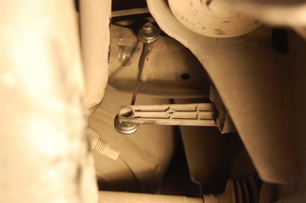

I decided to take off the front right stock rod first.

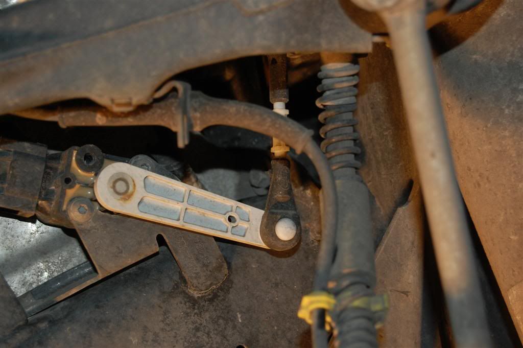

Pics of stock rod (it's focused on the sensor arm though):

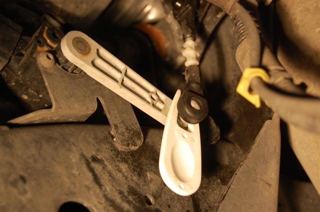

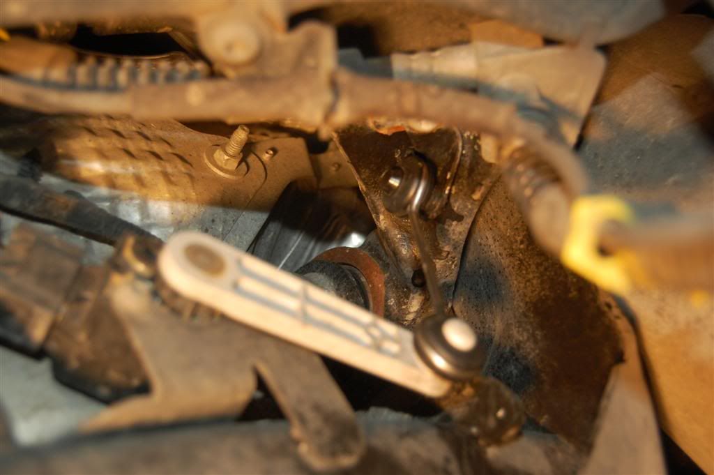

I chose to take off the end that was attached to the sensor arm first - my reasoning was that since the other end is stationary, it would help to keep the arm stable and make for less chance of breaking the sensor arm.

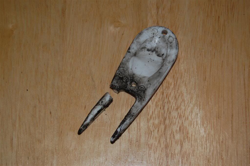

I also decided to use plastic golf divot removal tools, since I figured they would break first instead of the stock rod or sensor arm. I'd rather have that happen then break a part. Spray a bunch of silicone lube around the area and place the divot tool underneath, then you should be able to pull it off with your hand and a little prying action. The top or stationary mount you can get off without the divot tool (on both front and back); just remember to spray liberally with the silicone.
New rod on, just spray the mounts again and slide on. Simple.

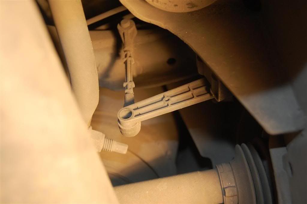

Heres the right rear.

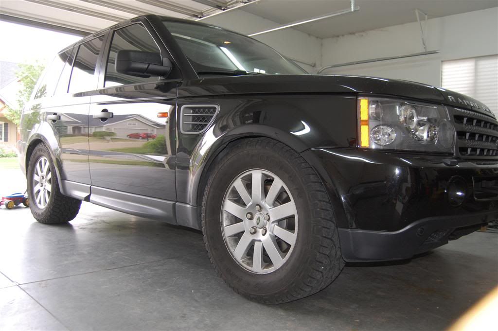

Access (stock).
Normal (stock).

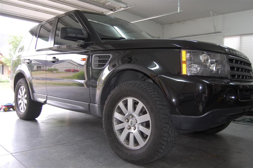

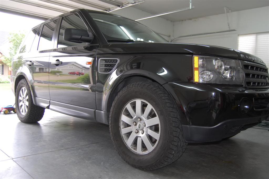

Off-Road (stock).

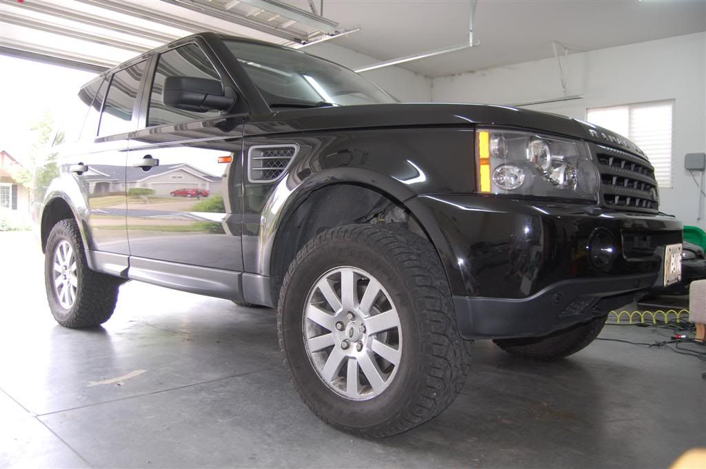

Off-Road (with rods).

I installed them when I replaced my zeons running approx 31.5 with some Goodyears which are a generous 32. Definitely need the rods. I went ahead an aligned them with the new tires. It does have the longer bounce you would expect, but I do not drive this like a car and do 3 G turns either. I recommend them, works great.
IMO I think all landrovers should have a bit of a lift and agressive tires!
