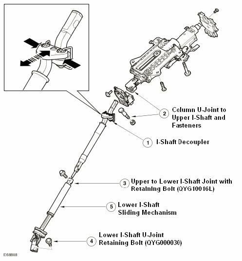

Posted this one already on another thread, added picture and repair procedure. Not that it will help any, but you never know...
TSB: LTB00097
Steering Column Knock – Repair Procedure
AFFECTED VEHICLE RANGE:
LR3 (LA) VIN: 5A000360 - 7A444606 Model Year: 2005-2007
Range Rover Sport (LS) VIN 6A900290 – 7A999999
7A100000 – 7A122778 Model Year: 2006 - 2007
CONDITION SUMMARY: MINOR 'KNOCKING' NOISE FROM THE STEERING INTERMEDIATE SHAFT
Situation: A customer may report a concern of a minor 'knocking' noise coming from the front of the vehicle or a steering system component while driving over small bumps or undulating road surfaces. A low resistance in the sliding mechanism of the lower steering shaft may be the cause of the noise.
Action: Should a customer express a concern related to the above condition, refer to the Repair Procedure detailed in this bulletin to diagnose and resolve the concern.
PARTS:
QLB500070 .............Upper Intermediate shaft Qty 1 (as required)
QMN500250.............Lower Intermediate shaft Qty 1 (as required)
QYG10016L.............Bolt (upper I-shaft to lower I-shaft) Qty 1 (as required)
QYG000030.............Bolt (lower I-shaft to steering gear) Qty 1 (as required)
REPAIR PROCEDURE
INSPECT AND REPAIR STEERING SHAFT ASSEMBLY
NOTE: All inspection and repair procedures must be completed before determining if an intermediate shaft should be replaced. Component references may be found in Figure 1.
1. Inspect the upper and lower intermediate shaft assembly as follows:
• Inspect the upper intermediate shaft 'decoupler' assembly for excessive movement. (Arrowed in Figure 1 inset)
• Inspect the upper intermediate shaft decoupler assembly and ensure the steel and rubber washers are correctly located. (Inset in Figure 1)
• Verify that the fasteners joining the steering column universal joint to the upper intermediate shaft are tightened to 30 Nm (22 lbf-ft). (2 in Figure 1)
• Inspect the joint between the upper intermediate shaft and lower intermediate shaft for any movement. (3 in Figure 1)
• Inspect the joint between the lower intermediate shaft universal joint and steering gear for any movement. (4 in Figure 1)
• Inspect the sliding mechanism of the lower intermediate shaft for any lateral 'play' or looseness. (5 in Figure 1)
2. If movement is discovered as quantified below, repair in sequence and as instructed:
• If excessive movement exists in the upper intermediate shaft 'decoupler' assembly, replace the upper intermediate shaft (QLB500070).
• If any of the decoupler assembly washers is incorrectly located, replace the upper intermediate shaft (QLB500070).
• If any movement exists in the connection between the upper intermediate shaft and lower intermediate shaft, replace the retaining bolt (QYG10016L) and tighten to 30 Nm (22 lbf-ft). (3 in Figure 1)
• If any movement exists in the connection between the lower intermediate shaft universal joint and steering gear, replace the retaining bolt (QYG000030) and tighten to 30 Nm (22 lbf-ft). (4 in Figure 1)
• If any lateral 'play' or looseness exists in the sliding mechanism of the lower intermediate shaft, replace the lower intermediate shaft (QMN500250).
3. After replacing any components, ensure the integrity of the steering shaft assembly and fasteners.
Figure 1:
#17 ·
No not as-per the TSB, it was as-per me getting very annoyed hearing my front end rattle like a 1984 corolla. I had it done on April 25,2007 and the noise is still there. According to my receipt they only replaced, QMN500250...Lower Intermediate shaft Qty 1 (as required). I wonder if they replaced all that stuff on the TSB you posted it would fix the clunk. Ill have to call LR when I get the chance. Thanks.
